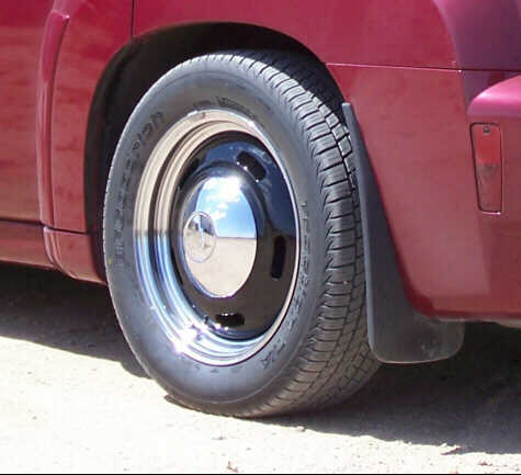

What size are Mitzkitty's? They look like what you need.
Old Jul 16, 2008 | 03:45 AM
Leon's Avatar
Joined: 02-04-2008
Posts: 294
From: Ridgecrest, California
Those are 16x6.5 and fit the HHR quite well. They're similar to what I have on mine, I have the slotted version, she has the smoothies. They're made by Wheel Vintiques
