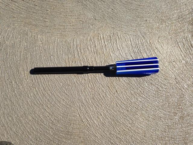

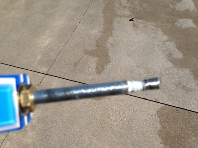

Here is a picture of the adapter I made
Old Mar 17, 2015 | 02:18 PM
Posts: 40,068
And the shifter plunger pin
Old Mar 17, 2015 | 02:20 PM
Posts: 40,068
And the assembled parts
Posts: 40,068

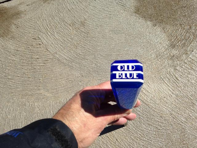

And my custom shifter knob
Old Mar 17, 2015 | 02:27 PM
Posts: 40,068
The black tube slides down over the stock shifter stick and the plunger pushes the release in the shifter stick I just have it in by fiction , I measured and cut the copper pipe to fit for length and gave the one end a tap of the hammer in squeeze the stick
