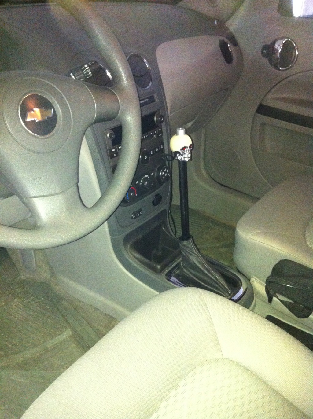

Here is what I have so far. I used steel tubing. Had to drill it out for the correct diameter to slide over the stock shaft. Then used 1/4-20 threaded rod as the plunger and drilled and tapped the push button on top of the skull head. The threaded rod is noisy sliding through the tube so I may change that
Attachment 23011
Oldblue Mar 17, 2015 07:25 PM
My shift knob is the plunger I don't have the button on the top, my fist attempt was with a 1/4 bolt and I changed it to the 3/8 to stop the rattleing.

Glad to see more autos with custom shifters. I am gonna build a few more so I can switch 'em out. You can also use aluminum tubing, or whatever you prefer. I have a few ideas to change it up a bit, some near, some far.

Same here, '07, no leather boot, no storage bin! While I had my shifter off yesterday to change the PRNDIL bulb, I inspected the area that commonly breaks and there did not seem to be any stress in that pin area, I did take the time to squirt some white lithium grease in there to lube the mechanism.

you have the removal of the stock shift knob correct. fairly easy. I emailed the vendor who sells the sickspeed knob and asked him if it will definitely fit the HHR like his add claims. He said it would. I got it last night and it will not work without adding a plunger piece. So I cut a piece of wood dowl about 1.5 inches. Then I got it to work. It looks good but feels a little loose. I ordered an aftermarket shifter boot that will cover the adapter better. I will post pics when I get that installed.
