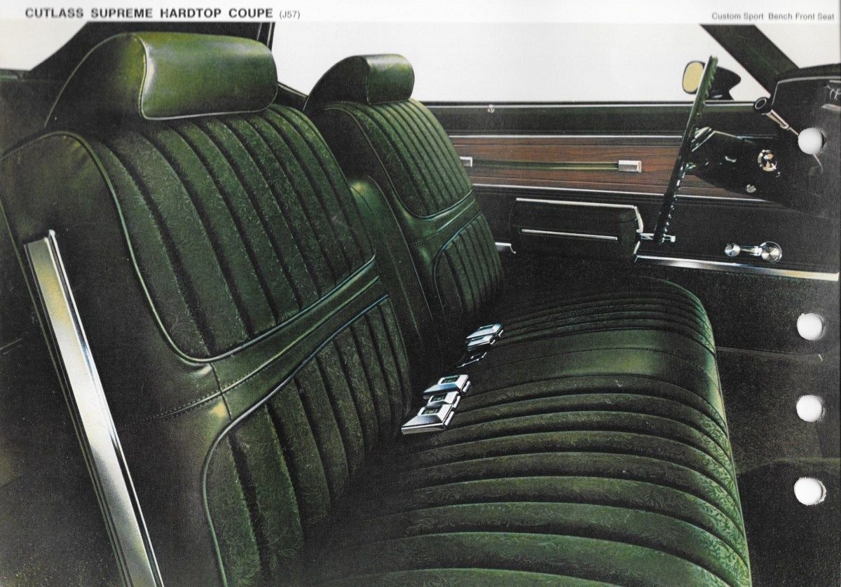

I always used the door pull strap, over there in the fake wood grain insert

I remember those. Dad had Regals, but the same strap was there. The strap never failed, but the trim covers popped off on his '83 all the time.

We were more into the 81-84 cutlass but I owned a few buicks too. My ex crashed one with that same green interior the day after Thanksgiving going to the store for something stupid on the busiest shopping day of the year on the busiest road in Kalamazoo. Ahhh the good ol days...
