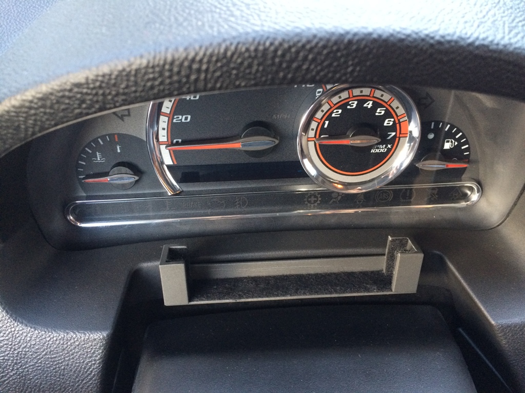

Just got my HHR a few weeks ago, after not being able to find any good spots to accomodate my old universal cell phone mount, I set out to make my own custom piece. Just wanted to share some pictures:

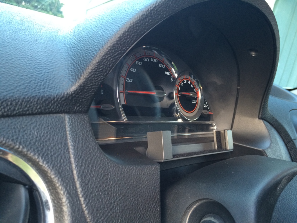

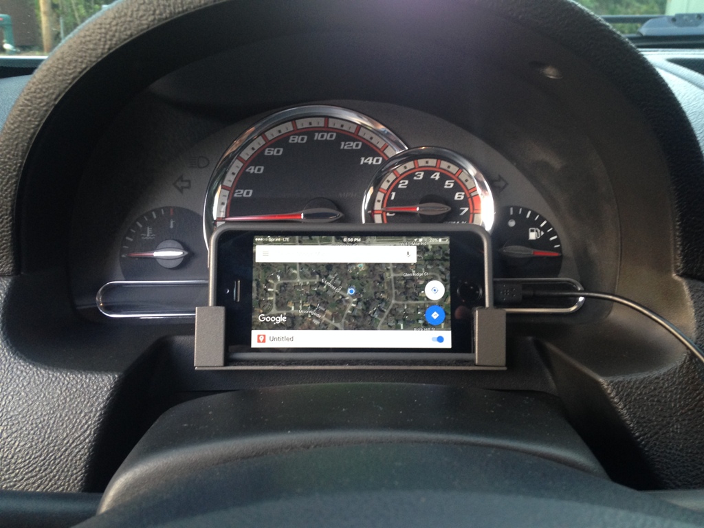

Bought some heavy aluminum channel from McMaster Carr and some aluminum angle from my local Ace Hardware. Drilled and tapped the heavy channels to mount screws into them from behind. Painted the metal with some engine paint and mounted felt tape inside to keep things snug. The height of the side pieces are such that the charging cable can still be inserted, the home button can still be pressed, and the ambient light sensor is still exposed.
I positioned the mount to keep the speedo and tach completely visible when the phone is in place, and when the phone is removed, nothing gets blocked. It does block the digital readout with the phone in place, but I only use this mount when using GPS so that doesn't really bother me. With the way it's mounted, the the wheel can tilt nearly all the way up as well. Works great, doesn't block my view of the road, but is still easy to glance down at the phone in that place and keep the road in my peripheral. Anyway, just wanted to share the idea with others. Thanks for looking!

Yup, that would definitely make a nice addition to the stock gauges. This mount design would work for most phones really, just have to play with how high you fasten it and which channels you choose... mcmaster has a large variety, so should be easy to find what you need. I used some rubber washers in between the aluminum angle and gauge bezel since the bezel is curved... helped take up the angular mismatch.
