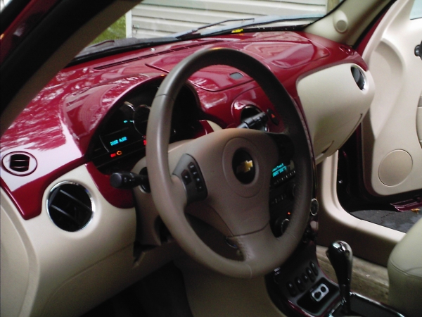

It is possible, a few here have removed it and had it customized.

thats my old hhr its a pain in the butt,but it can be done the worst part is the airbag,and sanding it smooth...

mostly clips hold it down i think theres a few screws ,in the middle vent in the top and in the top glove box and uder inside the gauge cluster.as for the air bag you have to take of the glove box (lower) and get on your back with and long 10mm socket and extenstion and there are 2 long bolts with nuts all the way at the top once they are taken all the way off the airbag comes right out and you have to take the cover off then and dont forget to unplug the airbag and remove the fuse.....as for the texture you have to wet sand it off but you have to be careful because if you sand in one place to long the plastic will get hot and will melt the dust and you will have a mess ,then you have to use filler to level the surface ,and i recommend a body shop for there is alot of prep to make sure the paint dont lift i hope this helps...anymore questions dont hesitate to ask.oh and there are screws behind the front of where the radio is

When I prep interior plastic I usually sand it first then spray it with adhession promoter (makes paint stick to plastic) if you skip using adhession promoter you'll probably have problems in the future with the paint not sticking, most of the time it's the heat from the sun that kills it. After adhession promoter You layer it wil heavy urathane filler prime used for autobody work this take several coats and alot of sanding. After you get it smooth it's ready for base coat/clear coat. It's usually a couple day job but looks great in the end.
As far as having it done.. remove the whole dash from the car.
