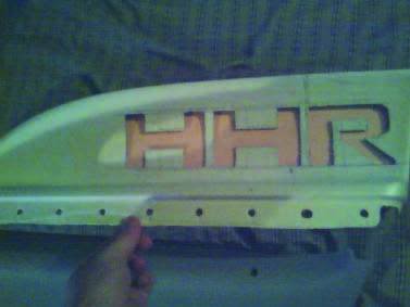

You can take it off. First you take off the whole door panel. Look at the back of the plastic door panel, you will see multiple plastic rivets, or plugs as we call em. They are hot glued. You can drill each one out to pop off the arm rest and trim piece. When you go to put the piece back on you would just hot glue the stem back in the hole. I have done this on hundreds of cars and have been doing numerous things to my doors where I have had this off and on about 20 times.

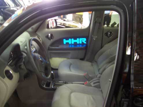

Dude that is awesome news, I can dig that. By the way I dig the HHR logo in the doors, did you do that by yourself?

Cool, thanks. I did do that. I am building my car for use as my companies demo car to showcase our flat flexible light panels. The doors as picture no longer exist as I am now building a complete fiberglass door panel now.
