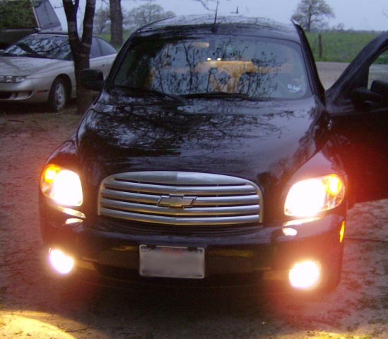

Finaly got some pictures put up had the flu and it put me down for a bit.

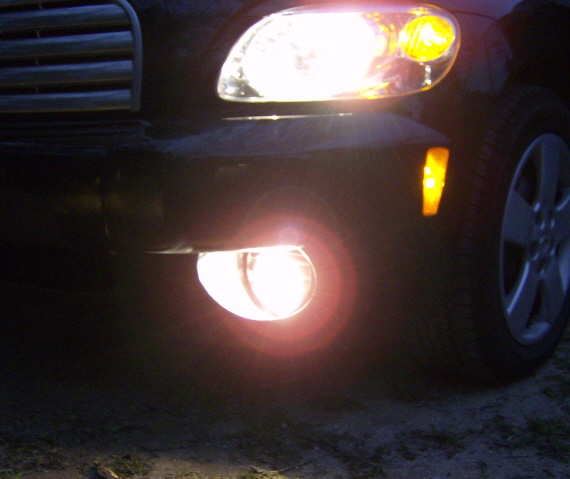

Here are the foglights installed:

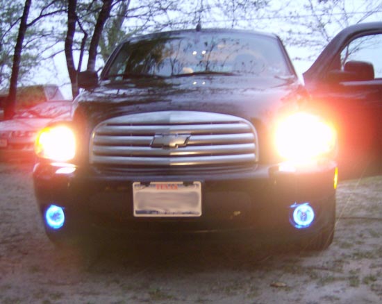

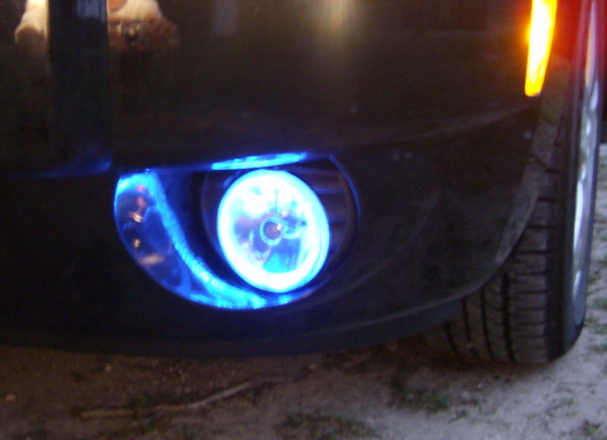

The Halo's I have them on blue:

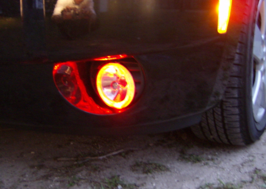

And Red
there are seven colors in all but I am not posting pictures of them all

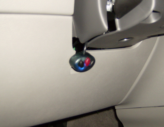

The switch:

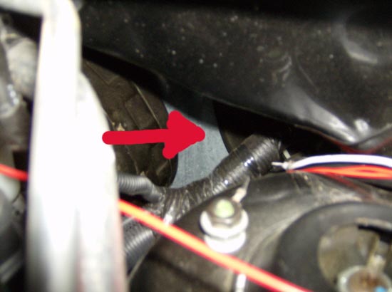

I ran the switch wire thru the fire wall on the drivers side there is a rubber stopper that can be pushed out to allow the wire thru:

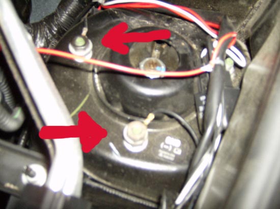

The two grounds are located at the bolts for the Struts there is a ground sticker located right there.

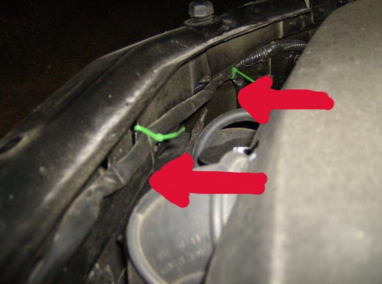

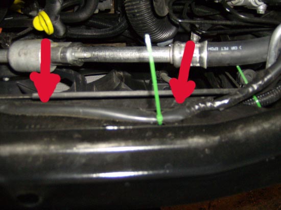

The wires are run and fastened with zip ties the wires are all wrapped when they came in so they are protected:
