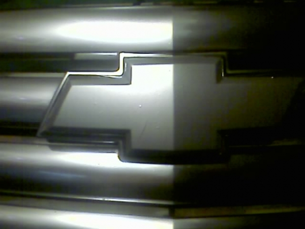

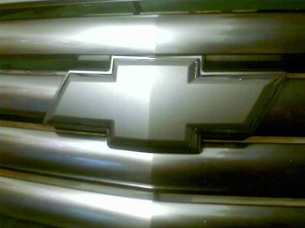

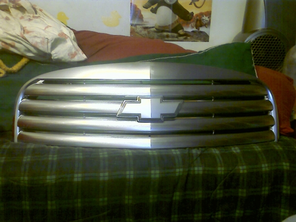

ok guys just to let you all know im a decal maker and since im not a supporting vender at this time (working on it ) im just showing you all the front bowtie overlay i made.
this is version 1 as you can see its a complete wrap no gold like 90% of other companys out there
process used and it takes some time to do to make it look good
cut my chevy bowtie shape bigger then actual emblem
used wet technique where you use a soapy solution
got it centered up used heat gun to dry the area.
next used finger to to smooth down the vinyl
used heat gunt to smooth creases and contours in vinyl from the corners of the bowtie
since im own a business i will not put my info in my posting nor will i post a price
im waiting on site owner to contact me back.
anyways
ON TO THE PICS
as you can see thereis an air bubble those will work out on there own in a week of driving
grill donated by mother with her 2009 hhr
pics on car will come tomarrow as its dark now
