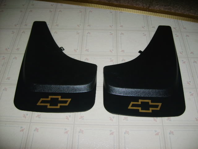

Here's one I just took of mine out of the package. Not sure why they have different tabs either.

Deb, I got that set originally, installed the rears. It was a bit of a pain in the you know what to get them on, lots of trimming and drilling involved. Got them too low, they dragged on a lot of things, and didn't fit real well. Gave up and bought the moulded set. Took 15 minutes to install all 4, and they fit much better. For my 2 cents, I'd send them back (or put'em on fleaBay) and spend the extra for the moulded. You'll be much happier with them.
