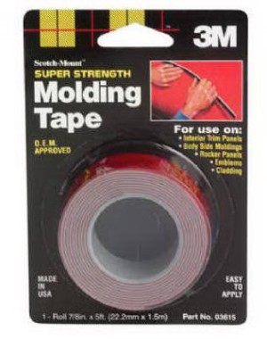

Now, I haven't done it..........yet.
But I have read that yes, grind the post off. Then, apply the following 3M tape to the back:
Part # 03615. Automotive stores should carry it.
Use an X acto knife to trim real nice, then peel and place on your HHR. Make sure you remove any wax from the body with alcohol before applying or it will work it's way off. And make sure your aim is good! It will be hard to work around once it's attached.

You can buy the double sided tape at most auto parts stores or Walmart, like the stuff Firewatcher posted above.
I took a pair of pliers and snapped off the posts. Then I used my dremel tool to remove the excess left so it was nice and flat. Then I took the tape and placed the emblem on there. This is where the fun starts.
With an exacto knife you need to cut in and around each letter on the emblem. Took me a couple hours to do both of them. Then use some alcohol to remove the wax from the area you are placing the emblem. You might want to test fit where it's going to go, as it may need to be bent slightly to fit the contour of the car. You might even want to use some sort of chalk or marking pen (dry erase) to indicate where it needs to be placed. I eyeballed mine and it turned out really nice I think.
