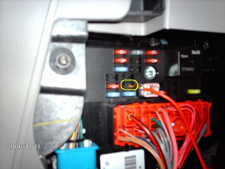

Keyed iginition source (turns off with key).

But, Solmans suggestion is the most professional. If you wire "hot" to the battery and for some reason you forget to manually turn off the running lights (assuming you are installing the correct wire size, fuse and switch) you will kill the battery. And that could be a pain, as some members have indicated.
If you wire FROM the ignition control fuse, the lights will turn off, if you walk away from the car. Sounds like the right thing to do, to me.
If you wire HOT from the battery, I would suggest an illuminated rocker switch to indicate when the running lights are on. Might save you some greeeeeffffff.
