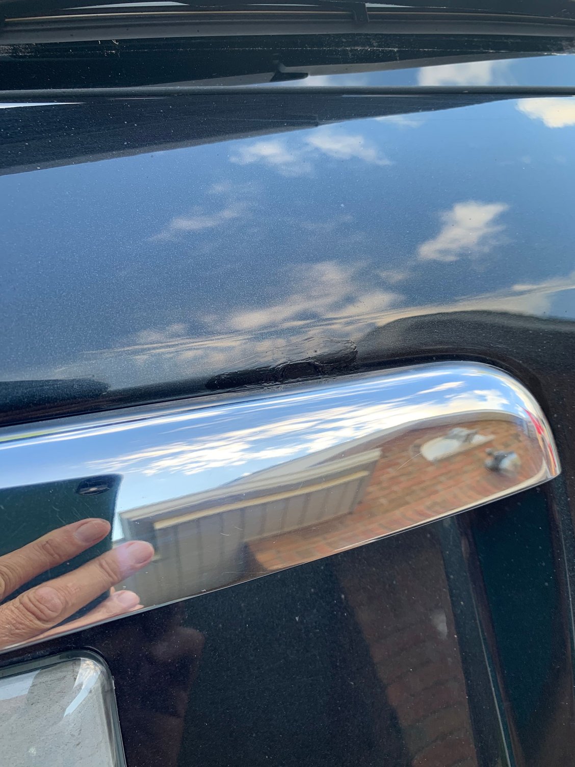

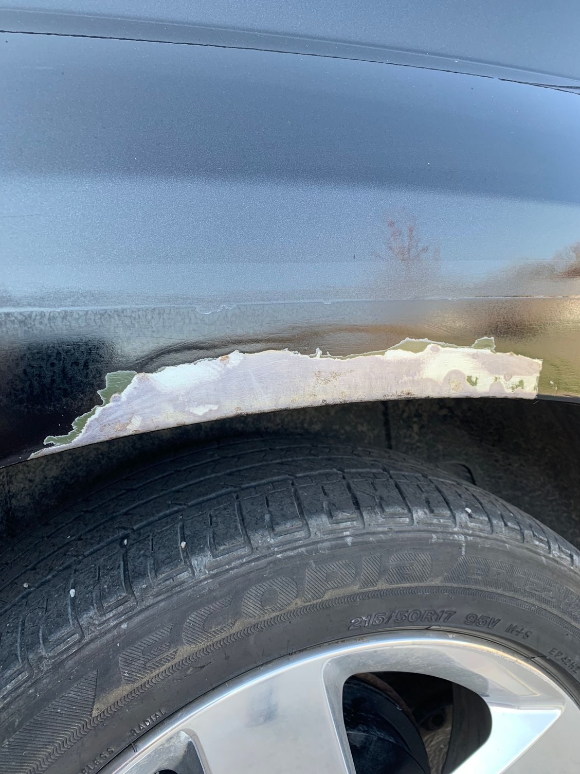

Today I continued the task of tackling the rust bubbles behind the rear beauty bar!!
The driver’s side chip on the end

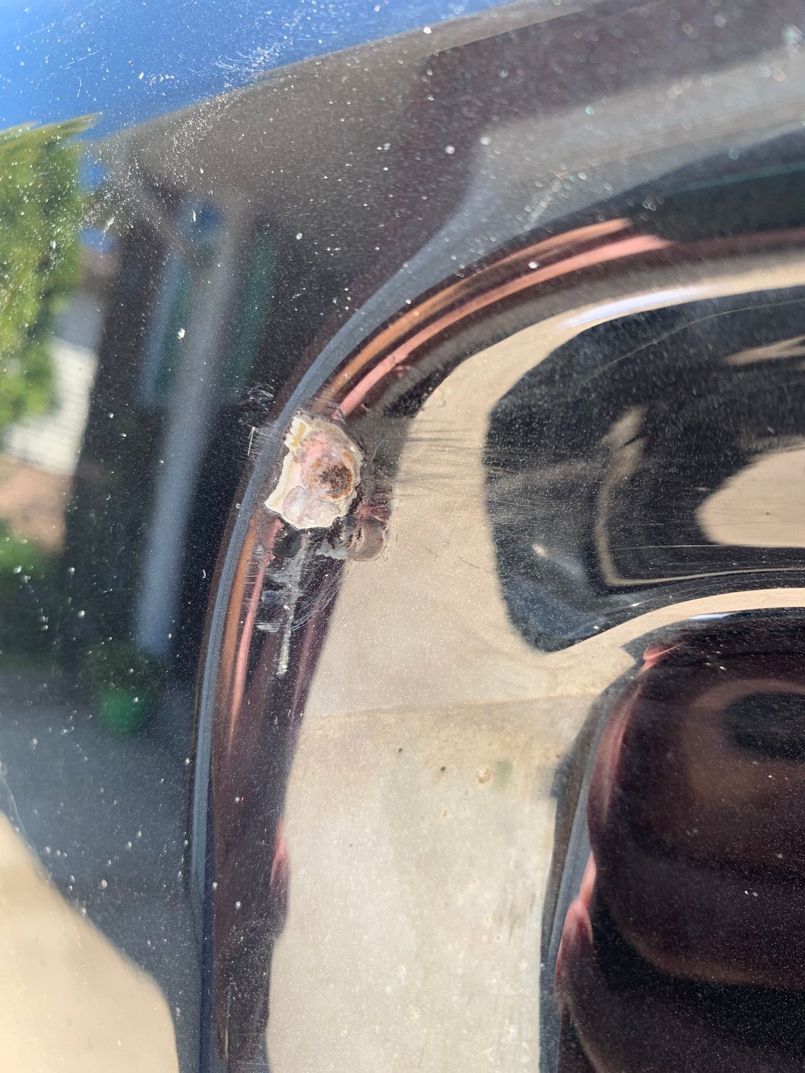

Driver’s side by the fastener hole

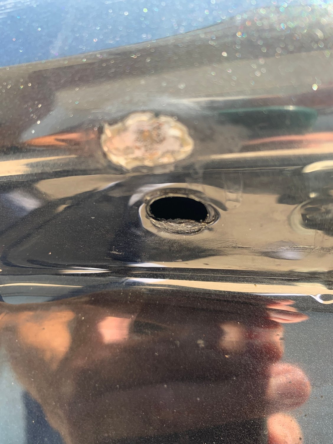

Similar over here on the passenger side fastener hole
possibility that the nuts were tightened to much , possibly that road grit and winter salt and sand got in between the bar and the painted body surface.
There photos show with a coat of rust encapsulator on the sheet metal, I used a razor blade to cut away the paint to expose the rust. A little sanding to give grip to the primer coat .

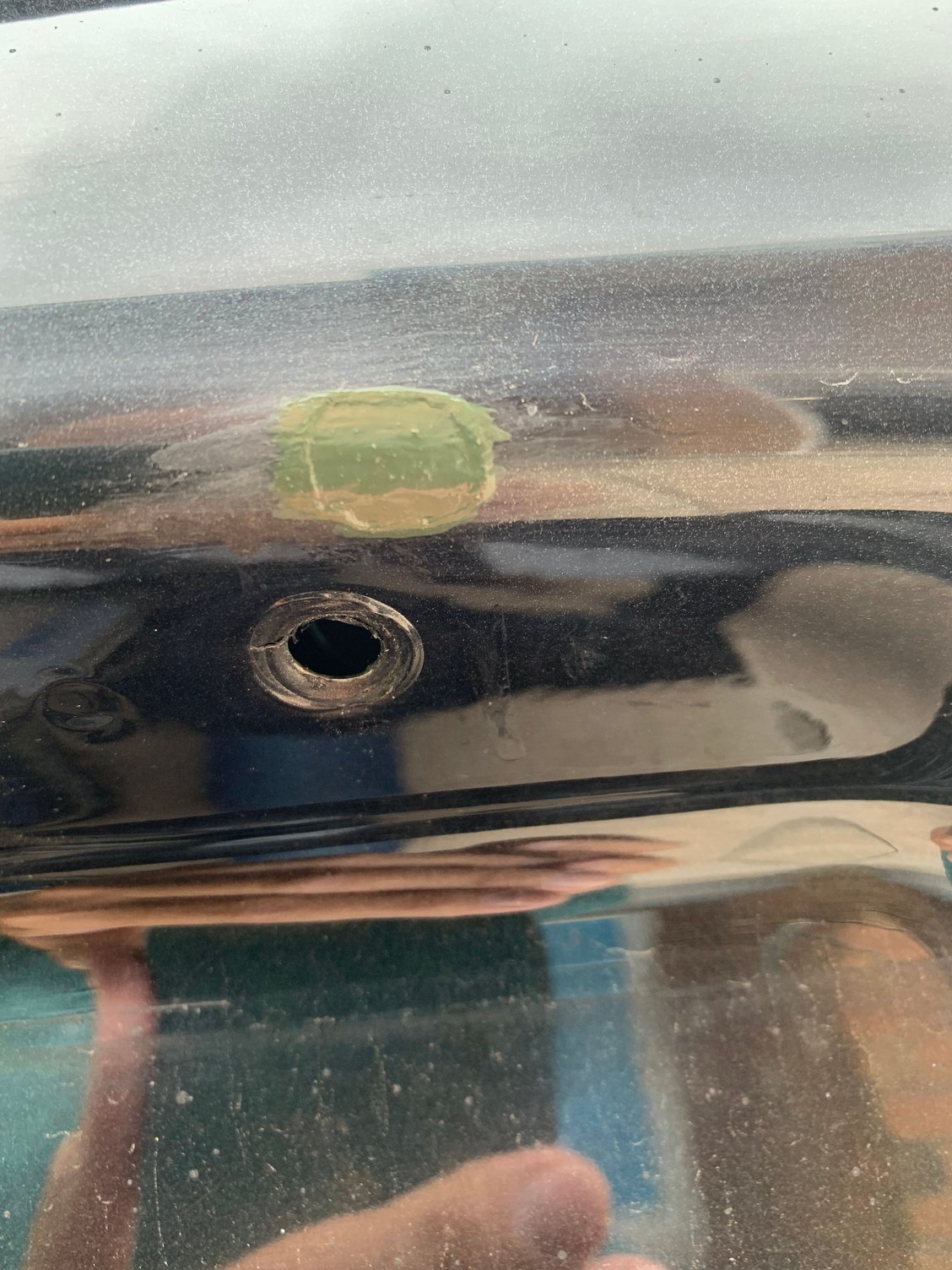

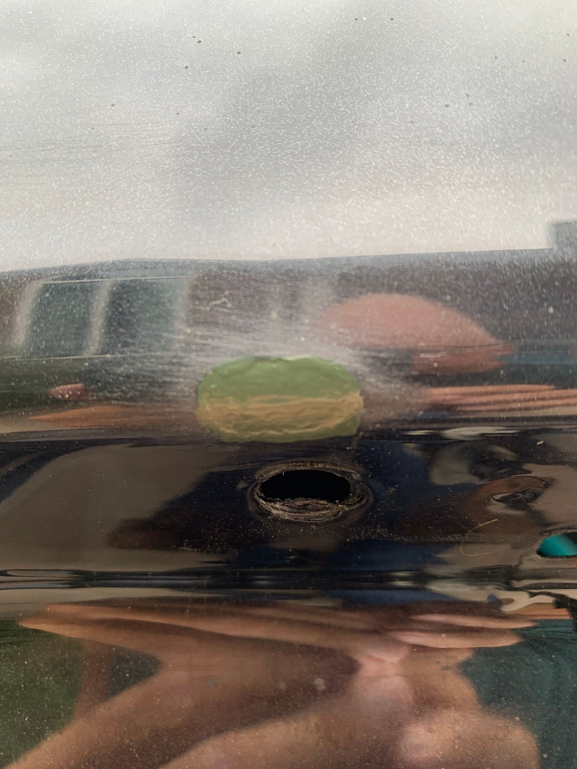

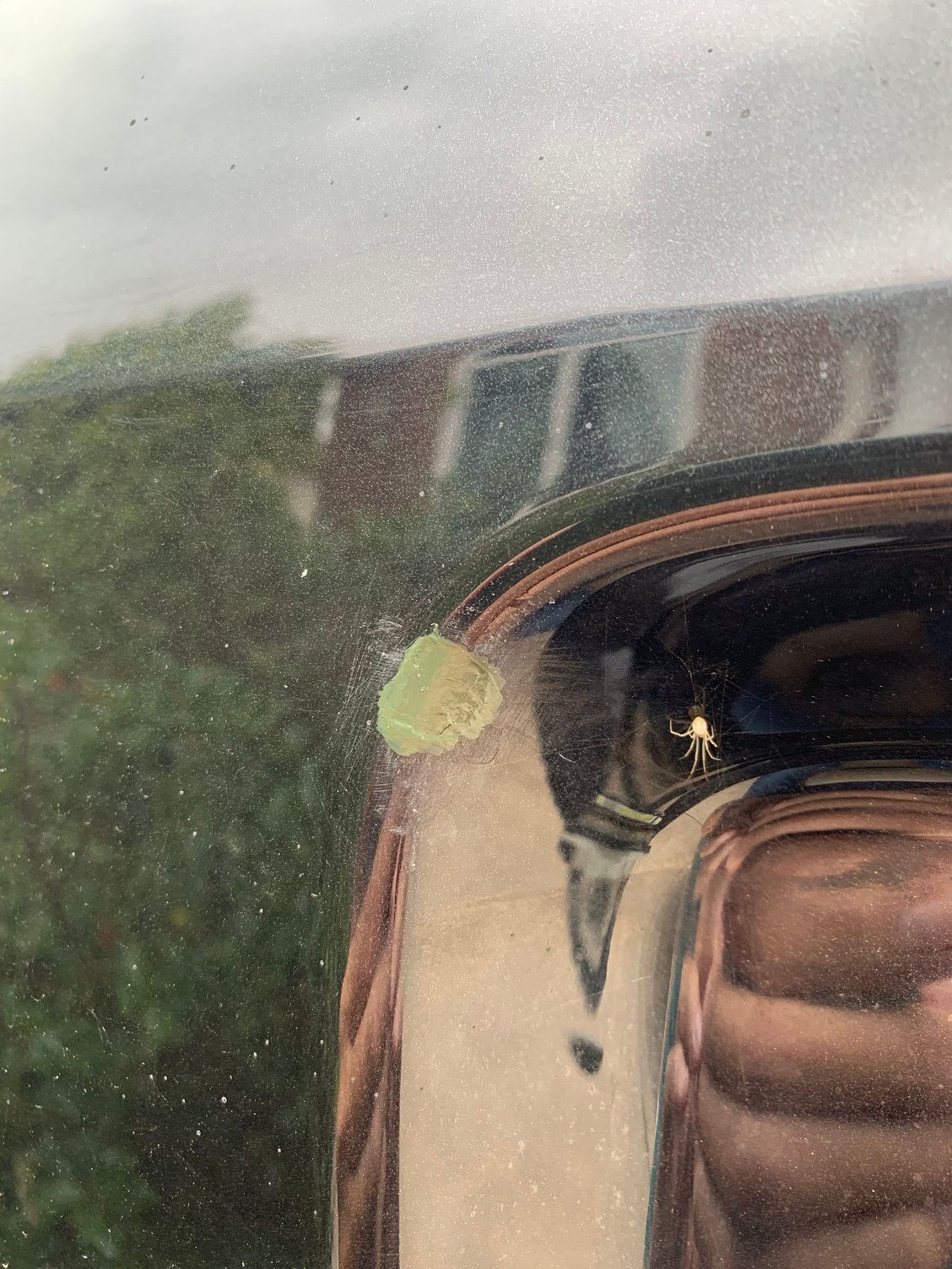

This morning, I applied the self etching primer, I used an old Tupperware dish to spray some paint into , then used a dollar store touch up artists brush , to save from taping , masking and over spray! It’s an 11 year old car, so I’m sure it’s just a DD no more car shows.
Driver’s side end
Passenger side above the fastener hole
Driver’s side above the fastener hole

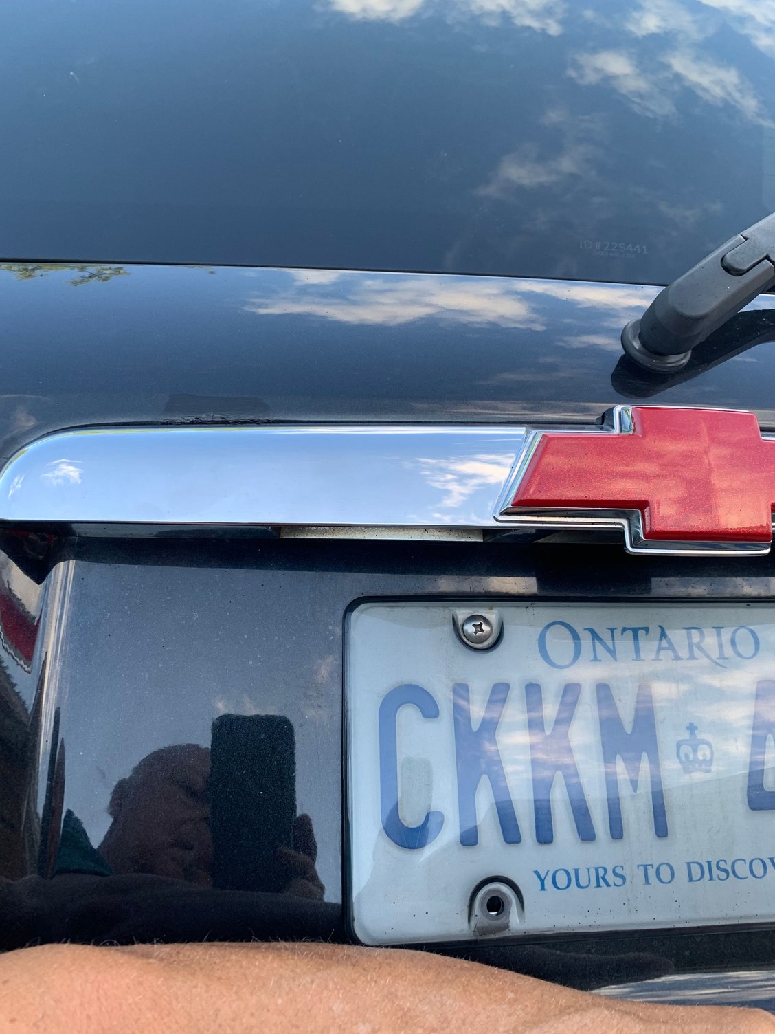

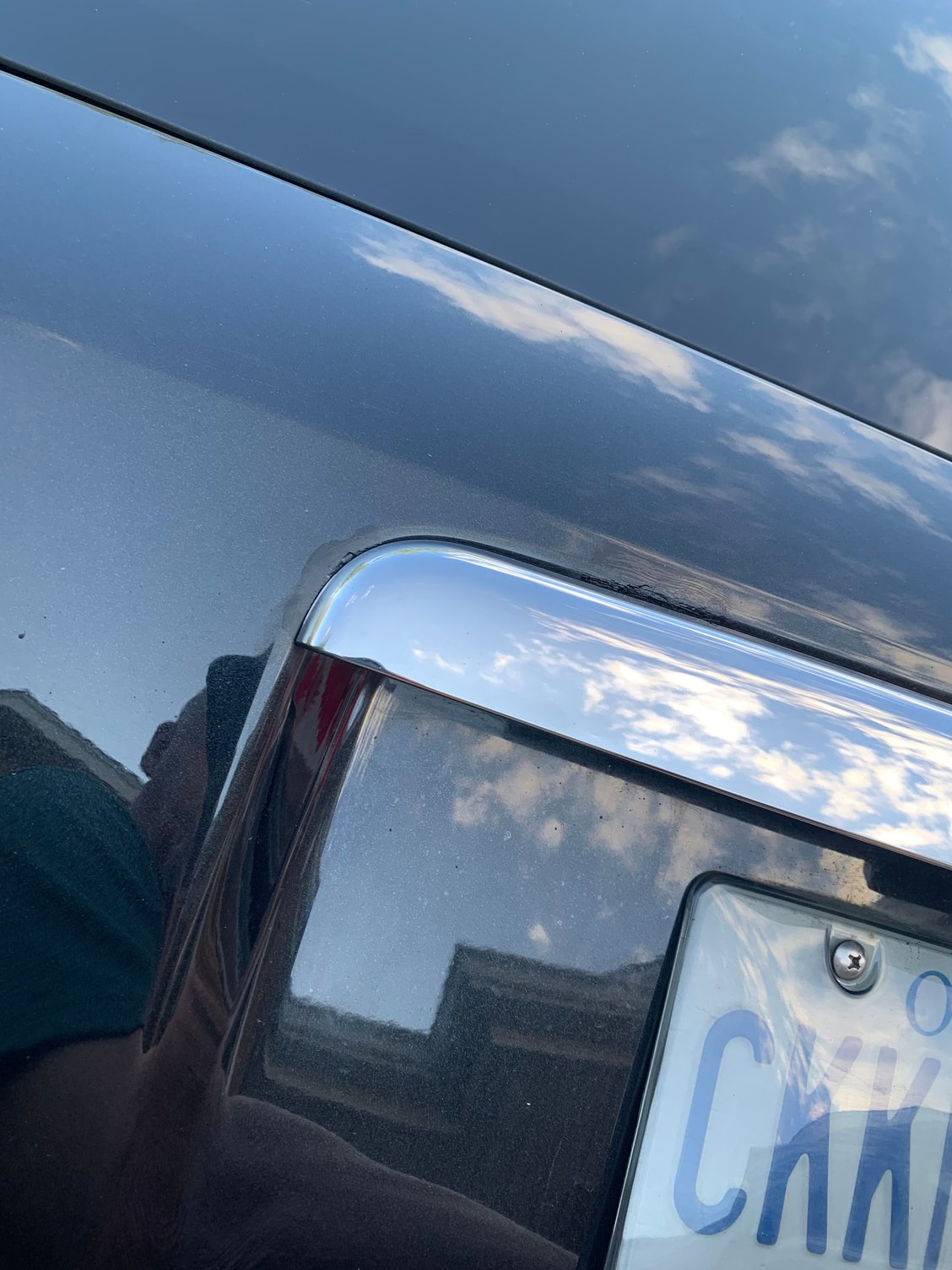

Colour coat done , and after supper it was dry enough to reassemble the beauty bar
It’s not perfect, but neither is the rest of the car
The driver’s side end
The passenger side .
