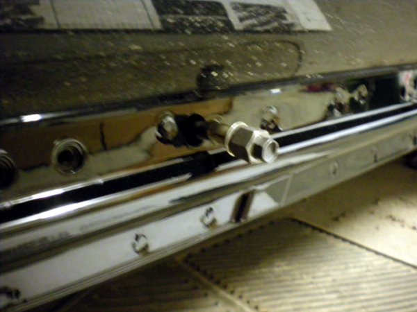

After much tugging, twisting & some cursing I was able to get the rocker panels off. Many tabs were sacrificed There was a lot of dirt trapped in there. Perhaps an ancient artifact or two fell out
It cleaned up nicely though (love that GM paint)
Since the hardware was not individually marked I had to seperate the parts out to figure out what a "riv nut" was (upper right corner)
You insert these riv nuts into holes in the rocker. These will be the threaded holes that attach the brackets for the running boards to the rocker panel.
Installing the riv nuts using the supplied tool & a 15mm open end wrench (which I did not have. Had to borrow a bicycle tool from the neighbor) & a 10mm socket.
Here's what the installed riv nut looks like
And the finished look (I still have to wash it so no close-ups yet)
Overall this was one of the more difficult part installations for me. As others have noted, the second running board went on much quicker. I kinda like the look because the silver color matches the door handle, grill & rear bar color. But I think it would look better with a silver wheel. I may still remove them later & have them painted black. Any other opinions on the look??
