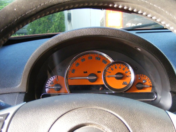

picked these up on ebay..bit of a task to install but thats what Moson Canadian is for...

How difficult is the install? It always seems to result in more rattles when I have tried on other vehicles.

not bad..dash cover had to come up a bit to allow the cluster to come out and the plug in the back definitly came from mexico but i figured it out..these are just overlays and must me put on with patience and care..work out all the air bubbles for a good fit..the cluster is only held in with 2 bolts..dash cover the same..they are visible when the center piece is removed..plexiglass shield is only clips not glue..comes apart pretty easy..went back in just as easy..about 2 hour job with beer breaks..lol
one of our vendors carry different colors and here is the instruction on how to change the cluster http://hhrboutique.com/hhrclusterinstallation.asp

Did they fit over the needles,or did you have to take the needles out?

no need to remove needles..still a pain in the harse!!
