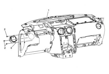

Yonash has it right. The whole dash has to come off. The problem is getting to the screws that hold the vent.
This is how easy it is after you spend the 4 hours to get the dash out.

The ones I removed were the little non adj vents above the those which seem to be viewed in Brad's diagram and they did pry out.
