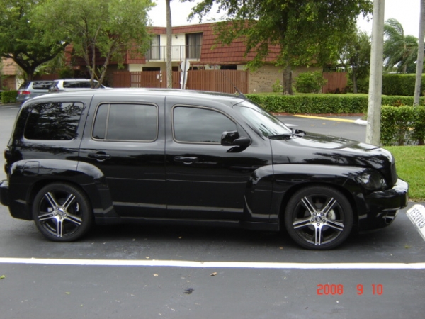

WOW!! That looks great!!

with black rims your HHR would be the sickest looking one i've seen, the headlights look awesome man. I love the all black look.

That is a similar look to what I am wanting, but with slightly different rims and precision grill. Looks great.

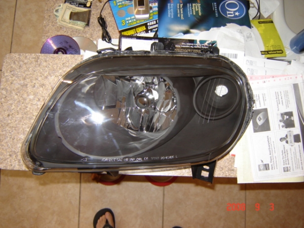

Im guessing you baked the lights to get them apart?

Thanks for all the complements. I baked them for about 20-30 min on 300 degrees. I painted everything on the inside in believe it or not flat black barbeque grill paint. Did everything myself except for installing them, my friend's shop did that. The headlight beam is actually more focused and I think it is better than before. Headlights are TYC got them on Ebay for $87 each.

Here is a picture of the headlight without the bulbs and off the car.

does the turn signal have a had time reflecting or look dim? how had is it to sepeate the light. was thinkin bout doing something similar but with a gloss black but i thought it might be a waste of time cuz i'm going to get the protective smoke headlight tint.
