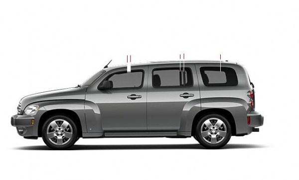

are you wanting the rear to be lower? like the whole roof slanted? if so instead of cutting the middle of the pillars out you will cut at the top of the window and have to change the angles. to get a idea of the work you will have to do print out a pic of the hhr. then using scissors cut it up and piece it together. that will tell you where you will need to add or subtract metal.
Old Jul 30, 2009 | 09:44 AM
garagebuilt's Avatar
Joined: 01-10-2006
Posts: 492
From: west columbia, texas
on just a regular chop here is where you would add unless you lay the front window back.
