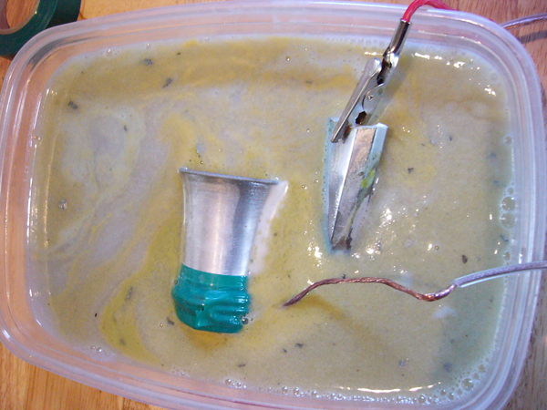

The solutions begins to turn green from the thick copper layer underneith the chrome reacting with the salt water:
2 shots after 10 minutes:

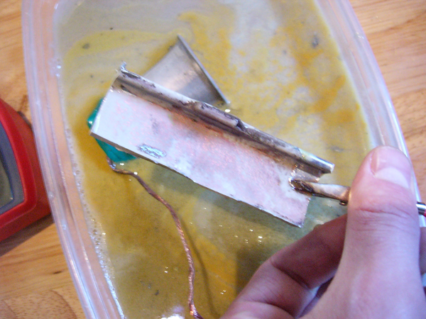

After 15 minutes I noticed that the chrome tends to come off faster on the side closest to the cathode, so I repositioned the electodes for the rest:
And here's all the chrome/copper floaties after 15 minutes:
And after 20 mins:
And finally, looks like in total it takes 25 minutes with this small scale set up:

And this is what happens if your aligator clip gets under the water for like 5 minutes:
And here it is de-chromed, no elbow grease or blood required, all washed and dryed. Obviously the chrome corner was out of the solution the whole time, so it's still chromed, but it serves as a good comparison:

Hmm. Problem is the connecting mech, ie: aligator clip, eats away way faster than the chrome, so the connection has to be out of the solution, or you will have connection no-more.
Ya, I was thinking something like that. It's just like I said, half at a time might work better because the connector has to stay out as anything metal or conductive in the solution and connecting in the circiut is eaten away.

BTW: Looks like the aligator clip was probably under for 10 mins, when I repositioned the electrodes. Still ate away fast! Also, for part of the time at the end, it may have been the only thing, between it and the chrome, still in contact with the solution.
