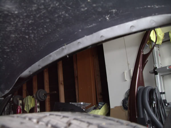

With my new discovery of the pre-rolled fender. I decided to just roll the fender some more. I taped up the handle of a breaker bar and pried between the fender and tire until I got the following results.
Here's a pic of inside the fender.
Here's a pic from a view down under. I outlined the fender in white so you can see it better.
Hopefully this is enough to clear the 245/30/20R tires on 20" x 8.5" +35 offset wheels.

First of all GREAT pictures The way the rear suspension is mounted in front of the rear wheels when the suspension moves up the wheels go up and forward just a little and even with rolled fenders up were the back of the rear door closes its not rolled on my car. I will have it trimmed and treated because that is were it hits on my car.
