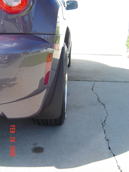

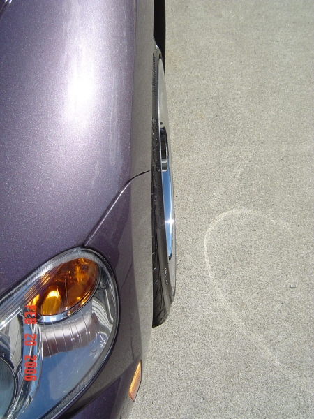

Here are some pics of how far the wheels stick out.
This is from the rear...
This is from the front...
Again, these are with 18 x 8.5 wheels, and 235/40-18 tires. I "tilted" the pics slightly just to get an image of the wheel itself, otherwise, if you look at them parallel to the wheel face, they are just within the fender line, and do not stick out. However, if you get a 7" or 8" wheel, with 34mm offset, they will stick just inside the fender well.
