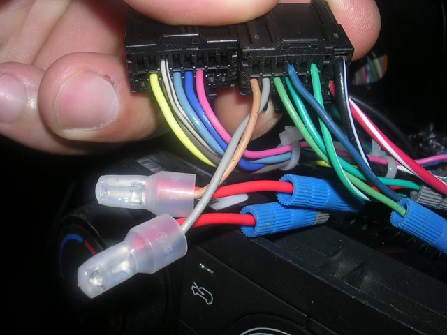

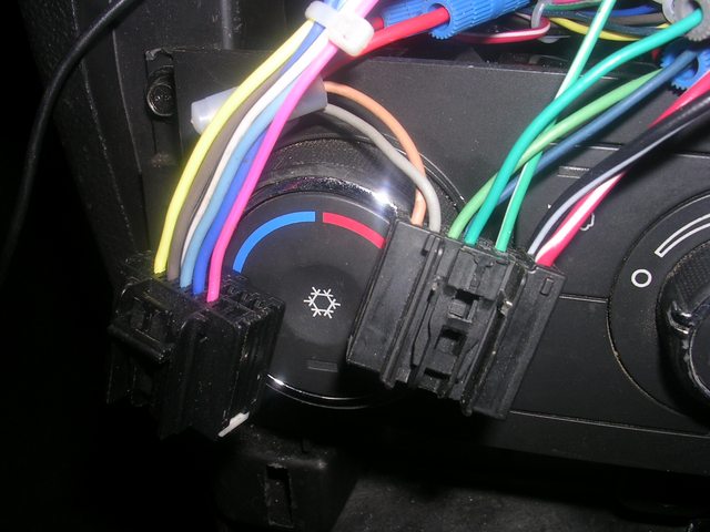

Can anyone tell me the pinout/diagram for the wires
2010 HHR LT. Please note the colors on my harnesses before posting diagrams, because I could not find the colors associated with mine.
Attachment 48061
Attachment 48062

Well these are what they should be....
Radio Battery Constant 12v+ Wire: Red/White
Radio Ground Wire: Black/White
Stereo Power Antenna Trigger Wire: Pink
Stereo Amp Turn-On Trigger Wire: Pink
Left Front Speaker Positive Wire (+): Tan
Left Front Speaker Negative Wire (-): Dark Green
Right Front Speaker Positive Wire (+): Light Green/White
Right Front Speaker Negative Wire (-): Light Green
Left Rear Speaker Positive Wire (+): Brown
Left Rear Speaker Negative Wire (-): Brown/White
Right Rear Speaker Positive Wire (+): Dark Blue
Right Rear Speaker Negative Wire (-): Tan
If that helps any.

Hi,
I know this is an old post, however I am attempting to upgrade my stereo and have found myself with the EXACT setup as the images above. It seems that only a select few vehicles have these different colored wires and I have found zero information on the color codes for them. As you can see in the image above, there is an orange wire, a light blue wire, a yellow wire, all that do not match with any of the 2011 Chevy HHR stereo color wire diagrams.
Does anyone have any information on this?
Thanks in advance for any and all replies :-)
donbrew Nov 18, 2019 08:21 PM
My book seems to agree with the photo.
https://cimg9.ibsrv.net/gimg/www.che...b847eb79f4.png
