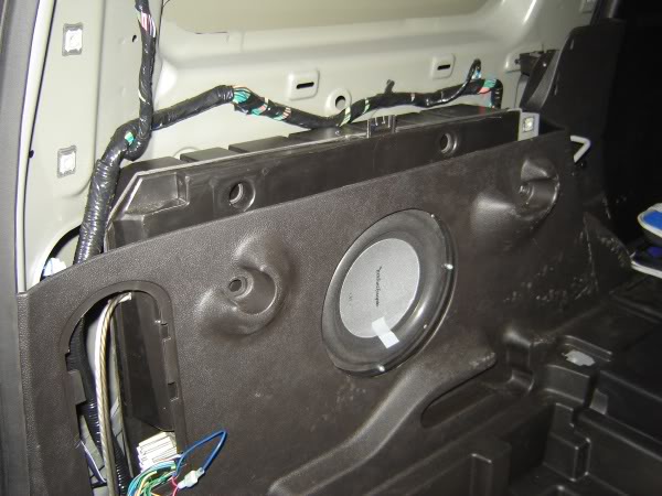

Mine came with a trim ring, but I'd like to protect it a little better. It doesn't fit good with the panel being so close anyway.
Soundstream has sweet grilles but I think the smallest they have is 10''.
I ordered the one from Audiobahn, I hope it fits perfectly...
This is what I'm working with:

I had to use a spacer behind the panel to prevent vibrations, then I used the ring that came with it. I cut out the circle for the oem opening. I screwed the trim ring into the spacer through the panel. Then I just popped the cover on. I painted mine Victory Red when I did a bunch of the interior pieces.
