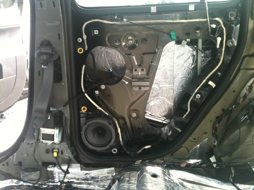

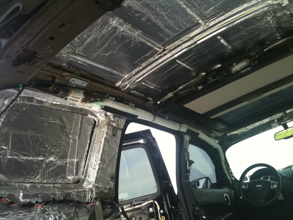

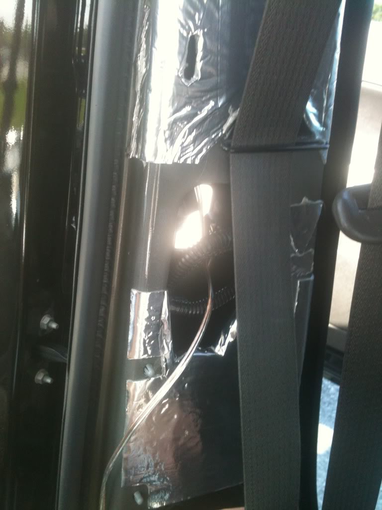

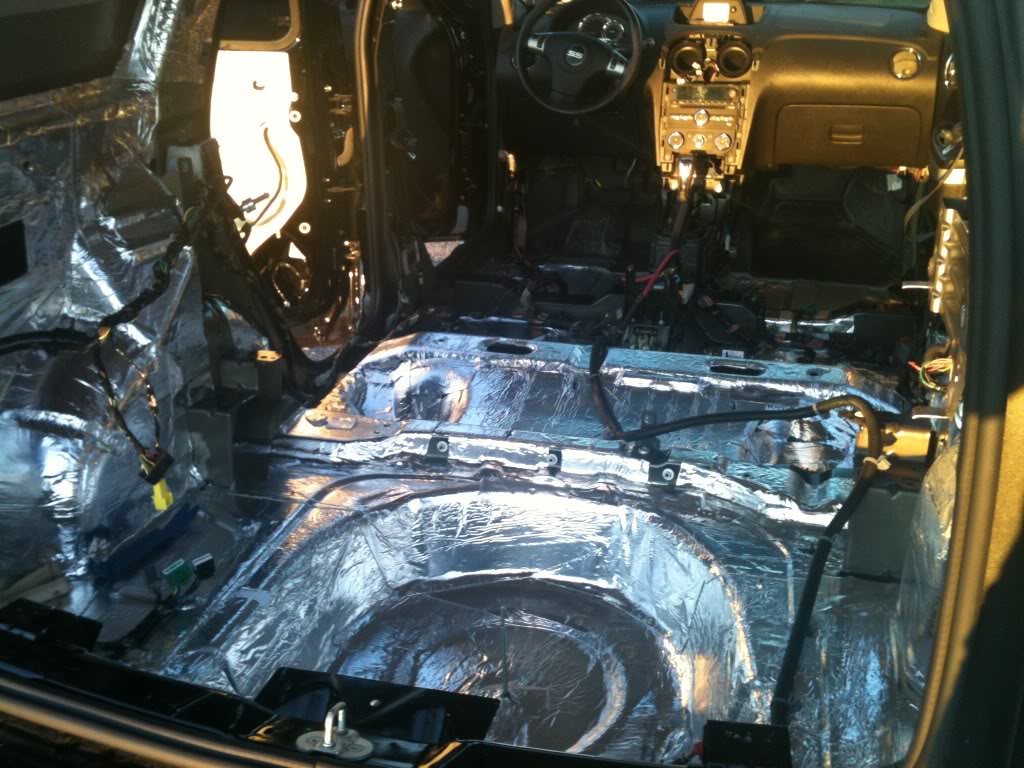

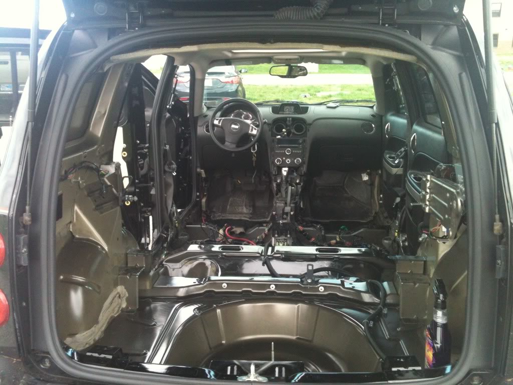

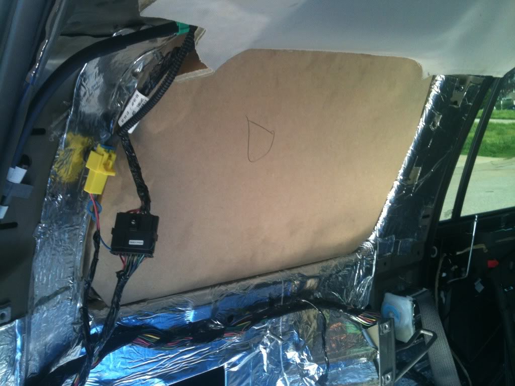

So with help from two real good guys I was able to get all the sound deadner in for the floor and the rear doors. Having three guys work all day on a car is much faster then I could do myself!
Before:
After:

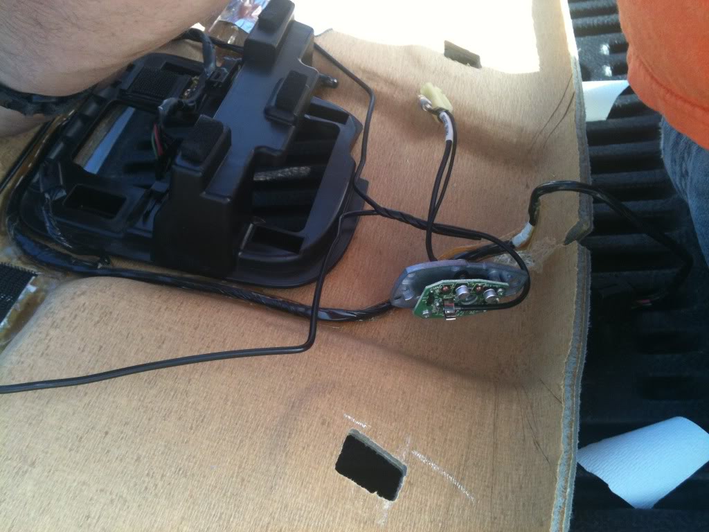

Additionally we pulled of the FM radio antenna on the front of the HHR and replaced it with a "homemade antenna" under the headliner. I'll be fitting a piece of metal over the old hole and using a small bottle of touch up paint to cover the space left by the shaved antenna.

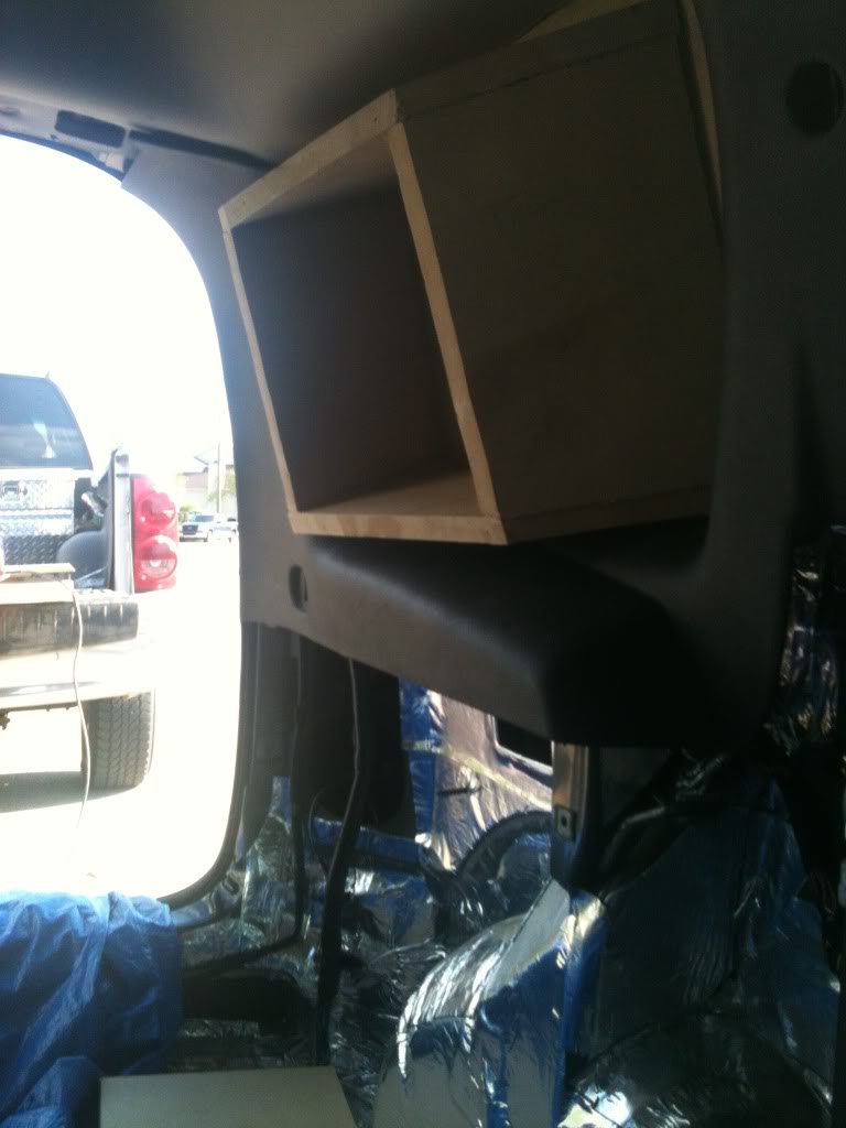

Built the boxes today but I forgot to take more pictures! Anyways here's what I have:

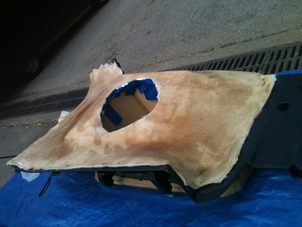

I forgot to update this, but the boxes were formed with fleece and resin before using fiberglass to add more of a shape to it. Where the antennea used to be on the front of the car was welded a very small plate before being grinded down and bondo was applied. New wire was run through the gromets in the doors for the speakers and I picked up a new washer fluid tank out of a Mazda B2000 to mount out of the way of my new intake.
