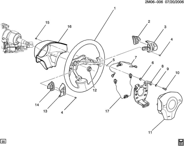

You can find what your looking for here.
Pick your year from the menu...or search.
looks like youll need items 2-3-7
http://parts.nalleygmc.com/showAssem...chString=wheel
Sorry I dont have any pics to remove the panel.

SS HHR Wheel
http://l.yimg.com/dv/izp/chevrolet_h...eringwheel.jpg
If you look at a close up of the radio/onstar wheel insert on the right of the wheel, you can see a couple of distinct phone icons along with the radio controls. After looking though another post on the forum talking about how to swap in radio controls I see that the blanks APPEAR identical save that the one of the SS has the phone icons and the one from the radio post does not. Could the phone icons simply be cosmetic and any insert will work?
Also, do you, or anyone reading this for that matter, know if you can pair your phone using only the onstar controls on your rearview mirror?
After looking though another post on the forum talking about how to swap in radio controls I see that the blanks APPEAR identical save that the one on the SS has the phone icons and the one from the radio post does not. Could the phone icons simply be cosmetic and any insert will work?
You can use either switch with the Bluetooth VCIM.
