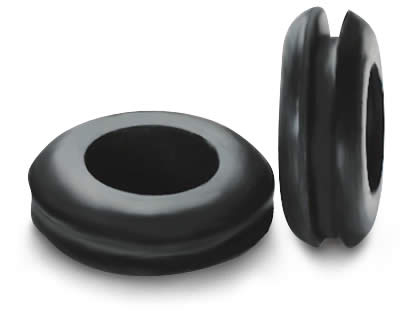

If no hole you can use, you'll have to drill one and use a rubber grommet.
Get in different sizes at just about any hardware store.
Make SURE you dab some Primer on the drilled hole them dab on some touch up colore after the primer dries awhile.
(You want to PREVENT Rusting!)
Get some clear or black silicone caulk and use it around the grommet as yoiu install it and then again after you slide the wires through to Prevent any water from getting in.

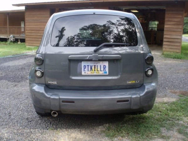

When I installed mine, I bit the bullet and drilled my rear hatch in the recessed area near the tag. It's high enough that it's shielded from direct rainfall. So far, so good.

^Nice plate, there!

backup camera angle?
i like it, killer, but having it off center does it give you a centered pic like i get.
pic soon.
