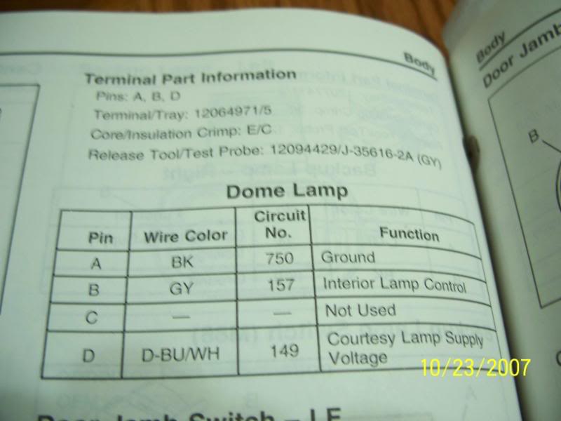

Anyone know what color the dome light wires are?

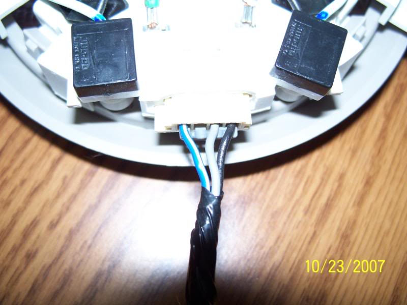

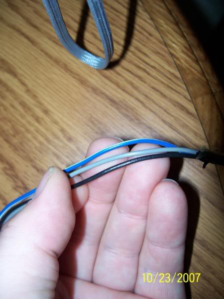

There are three wires:
Black...Ground
Grey....Interior Lamp Control
Blue/White Stripe......Courtesy Lamp Supply Voltage
