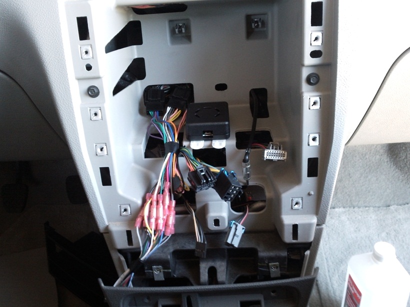

Here is my single din hu setup. The second pic shows the wire harness on the left and the chime box that the harness connects to which is in the middle. This was under $50 for the harness kit and makes it super easy. It makes it simple and quick. All you have to do is match the wire colors between the aftermarket HU and the harness kit then plug the harness kit into the factory radio connectors. Takes about 5-10 minutes for the wiring side of things.
