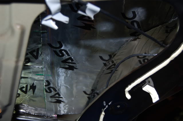

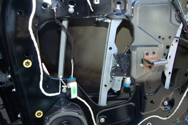

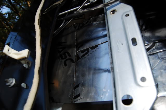

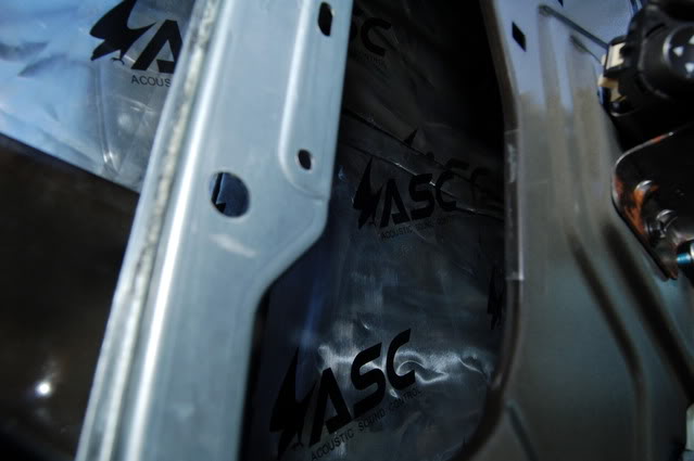

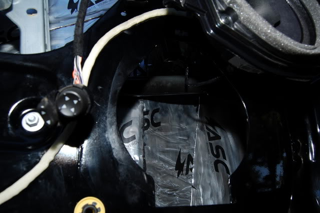

9 Attachment(s)
Continuing on here.
I tore the 4 door panels off and got started on sound deadening them.
The interior body, roof, and complete floor front to back are Done.
A few pics for those interested in my little sound project.
Attachment 28326
Attachment 28327
Attachment 28328
Attachment 28329
Attachment 28330
Attachment 28331
Attachment 28332
Attachment 28333
Attachment 28334

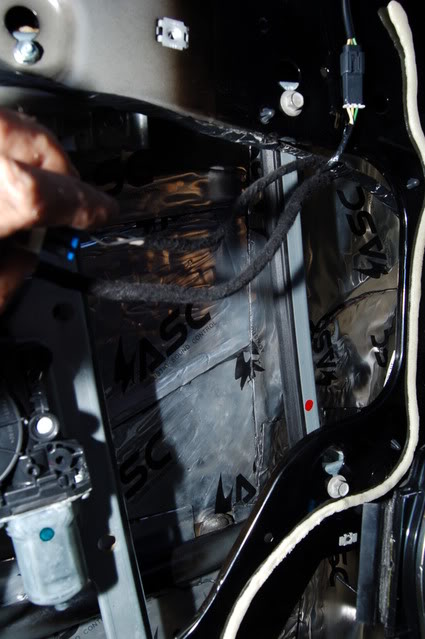

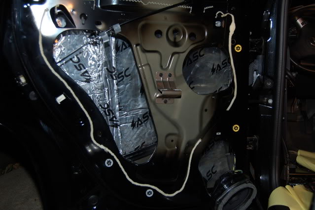

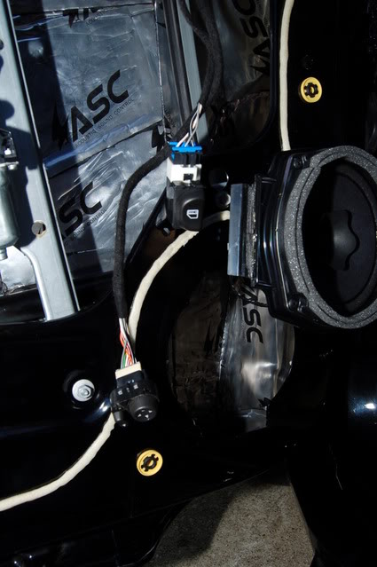

4 Attachment(s)
Previous pics were the Front doors. I started on the drivers door then moved to the rear door, I then went to the other side and started the passenger side rear door first.
The front door was a Biotch with the smaller openings and the window tracks in the way.
The rear doors, on the Panel at least are a Breeze to do inside. No window tracks in the way and the openings are larger.
I have the inside of the front passengers side left to do.
Then cover the doors on the inner side facing the backs of the door panels.
IF the rain holds off some, supposed to rain the next 3 days and be in the 90's, I should have it all Done tomorrow if I get a few dry hours in on it! :D
FINALLY ! :lol:
Install of the Stage 3 stuff is set up for Sunday. (fingers are Crossed)
Orangewhip is coming over to lend a hand wiring it all up.
I already got the Case of Coors light you wanted in the fridge here for you Brandon. ;)
I don't drink so it's all yours. :lol:
Then as I start putting the interior panels back in I will use some sound barrier on the backs of some until I run out at least. :thumb:
A few pics of the back doors.
Attachment 28322
Attachment 28323
Attachment 28324
Attachment 28325
BIG Difference in the sound of the doors with it versus the one door left without any installed yet. :twothumbs: :cool:

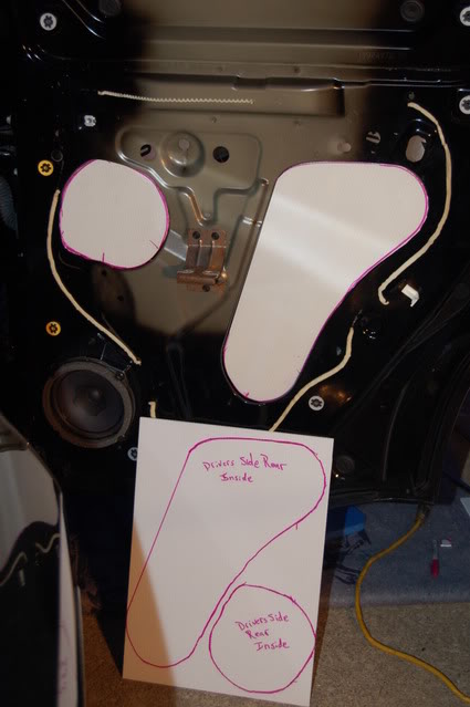

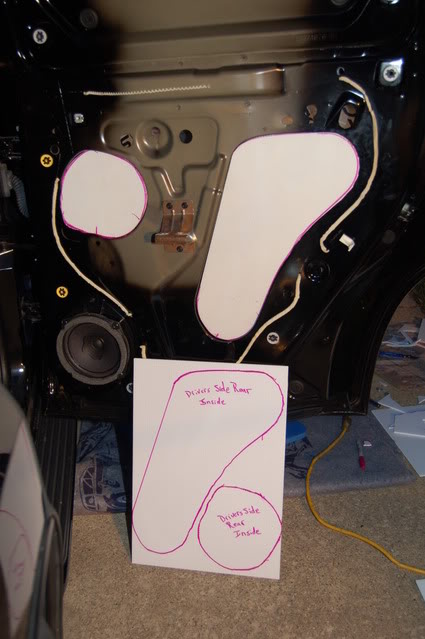

So this evening I am working on my doors some more, after finishing the last one on the inside, I started making these Fill In Pieces. :D
The doors each have 2 large access holes to work inside them, Not real good for Audio sound control.
I made these fills and will install them and then cover the inside of the doors with the Audio Barrier.
The fills are made of a double walled corrogated plastic, like a plastic cardboard.
These should help the speakers sound even better.
Keep in mind, another layer of the sound barrier goes over this.
Pics before I add that and cover it all up. :cool:
Attachment 28316
Attachment 28317
Attachment 28318
Getting Close to Rockin N Rollin here. :D
