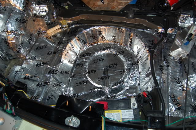

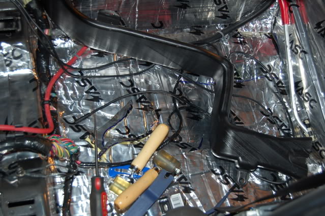

I have been Installing a product like "Dynamat" sold as - Audio Barrier, but actually comes in a Box that looks the Same as the Advertised "Sound Barrier" but the box says ASC (Accoustic Sound Control) with a website listed as- www.AmericanSoundConnection.com.
If you do a google search for Audio Barrier, you'll find 2 places selling it, I bought from half priced audio. When it arrived and had the ASC of the box I called them on it, and they swear it's the Audio Barrier. (Box does look the Same except for the name on it, so who knows.) I'll get a pic of the acxtuall box posted later on.
Comparing the box design I think they just started using the company name, so if you decide to order some up, don't be surprized.
Foil backed butyl based. Bought here>http://www.halfpricecaraudio.com/Audio-Barrier.htm
Supposed to be pretty good and for a better price than actual "Dynamat".
I bought $500.00 worth, it would have cost nearly Double that buying the big name brand everyone has heard of.
As they describe it>
Audio Barrier is a high quality manufacturer of car sound damping material that is a cost effective way of upgrading to increase the sound quality of your stereo system while keeping the road noises out at the same time. The sounding damping material is designed to create a barrier between unwanted noises and vibrations from the outside. Audio Barriers sound damping material can b used on floors, doors, roofs, hoods, and trunks.
Another website that carries it >http://www.hifisoundconnection.com/S...0046/set_num/2
And they have this on their site>

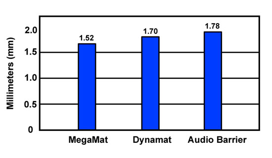

If you look at the graph above you will see we only compare our material to other brands that use butyl rubber as a base. As you can see we provide the thickest material, most square feet & the lowest price compared to top brands. Brands that use asphalt like FatMat, Sound Destroyer, & Rattle Trap sacrifice quality to cut costs. These brands are not even in the same league as major brands, so we dont even include them in our comparison.
Thickness matters just like with wire. With Wire you are paying for the copper inside and with Sound Damping you are paying for the thickness of the rubber. The more material the better the damping factor. You would have to apply up to 3 layers of some of our competitors material to equal one layer of ours.
So why does it matter what type of material your sound damping mat is made from? Sound damping material is broken down into two materials. Butyl Rubber and Asphalt based mixes.
If you look closely most of the cheaper brands use asphalt based material which in the long term will not hold together as well as rubber butyl and it also has a foul smell that will never leave your vehicle. On the other hand rubber butyl leaves no trace of odor and has better elastic properties to extend durability. Besides who wants their vehicle to smell like a road construction project?

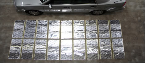

I bought 2 Bulk Kits @ 72 sq. ft. each kit. 18 sheets 18"X32" in each kit.
I also bought another Kit, smaller "Trunk Kit" that has 5 sheets @ 20 sq. ft..
I am upgrading my stock audio system, so sound dampening is a major step in my upgrade.

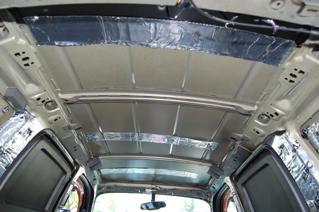

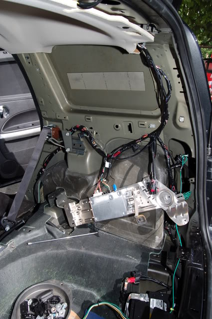

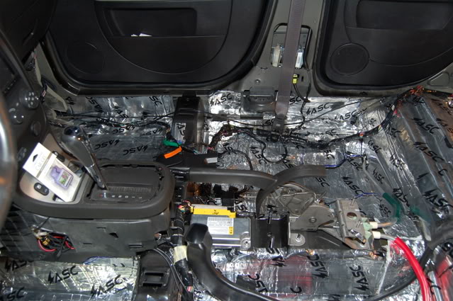

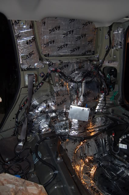

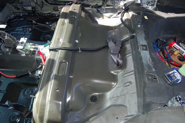

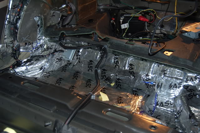

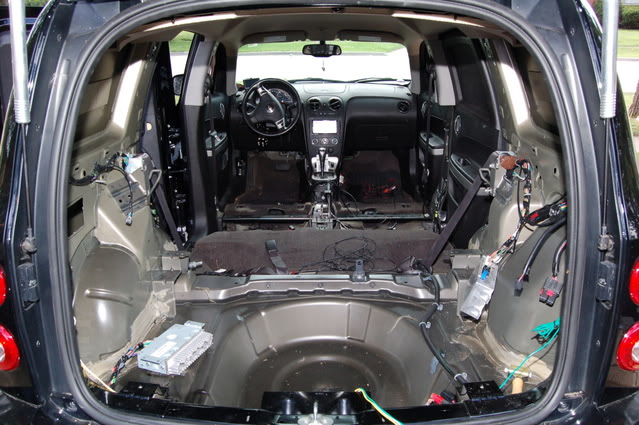

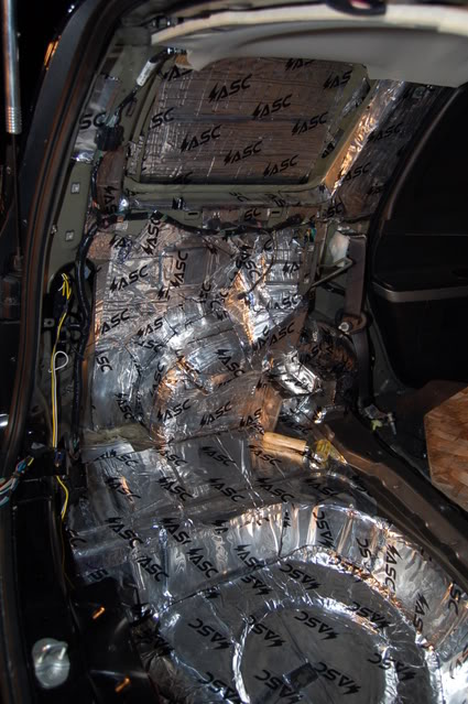

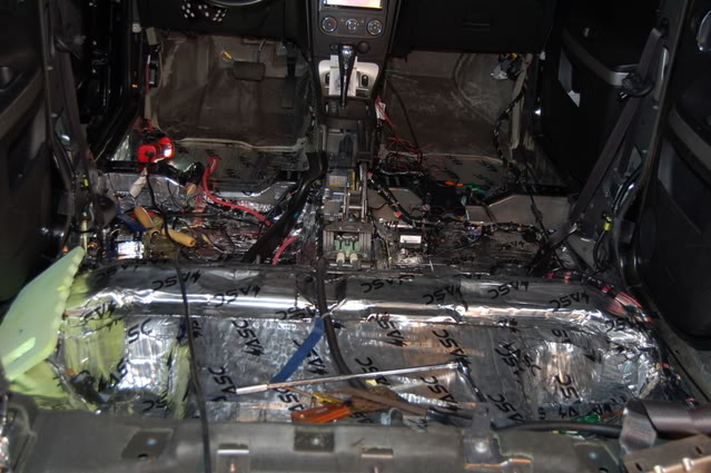

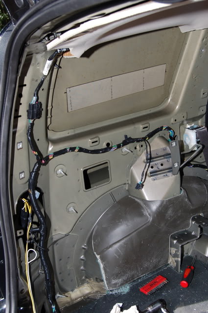

I have gutted my interior on my HHR Panel to do this work, to get at everything that needs to be covered.
I will be doing the Doors once the main interior is put back together.
It is alot of work, but I feel it will be worth it in the end. My Panel will be much quieter inside, sound and feel more like an expensive car that has much better sound proffing from the factory.
You gotta tear everything out to get at the areas that need covering.

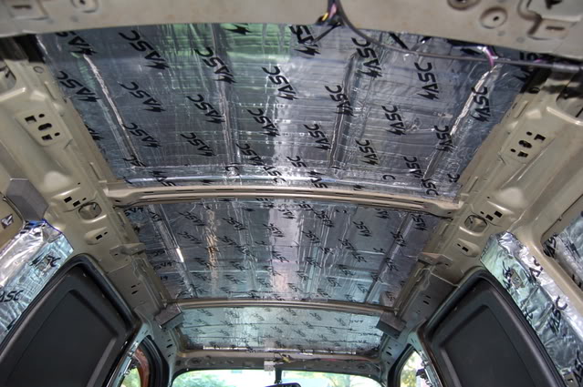

25%-50% Coverage is pretty good if you want to save some bucks.
I am doing 85%-95% Coverage. Some go to extremes and do 100% with TWO layers and put other products over that even. They are in the $1,000.00-$1,500.00 and more range.
I am doing what I felt I could afford and what would do a decent job for what I am after sound wise.

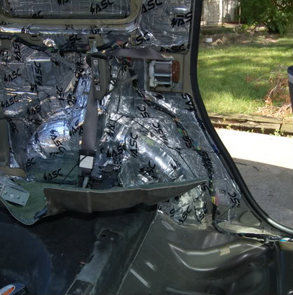

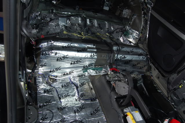

The panels before and after sound ALOT different. Tap the the HHR's Roof and it sound tinny and matallic with vibration. Once installed it has a Solid Thump sound now.
You can search and read and decide for yourself if this is a Project for you or not, I did my research, and decided it was worth the investment. And the time it takes.
I'll try and load the pics in somewhat of order here, but they may out of order as I worked on it and took pics as I went along.
I gutted the interior and started in the rear end doing the quarter panels, then the spare tire well and moved forward. The main body is about 90% Done now, still some fill ins here and there to do yet.

A few pics of my work in progress.
