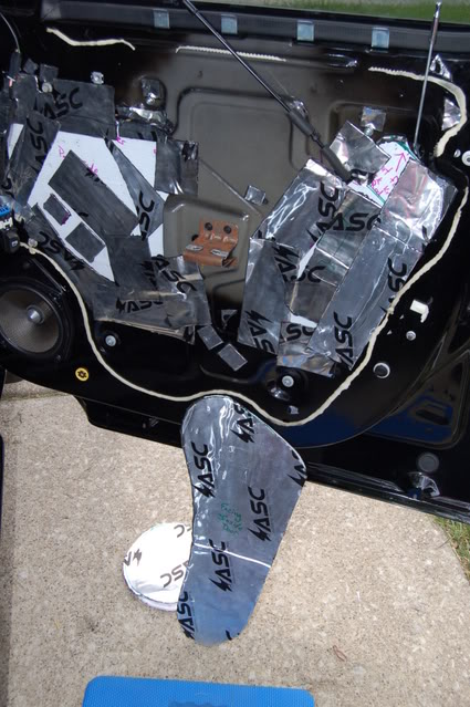

American & Proud Aug 1, 2011 10:56 PM
2 Attachment(s)
I got one of the doors done today. HOT and Humid today, one was enough. :lol:
I covered the back sides with 100% of the audio barrier, then I cut 3" strips and stuck them on the inside edges of the openings and Pressed the fillers into them.
Reaching in and pressing them as a sandwich together then on the second opening in the door I mounted the 3" strips and pulled them forward and out, then Pressed the filler piece into it to get a grip.
Covered all around the outsides edges and they are Locked in place now, can't fall out, or fall inside the doors.
Heres a look at one just about Done and ready to install the door panel.
3 more to go. :cool:
Attachment 28265
Attachment 28266
Fitting the interior panel, with the access openings filled in the door I hade to cut off 2 protrusions in the foam fillers on the back of the door panel.
I air sawed them off, then smoothed them down with a DA Sander and 100 grit. :thumb:
