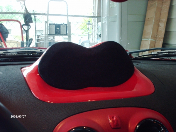

Something like this?

Thats pretty nice GDZHHR would certainly help!
