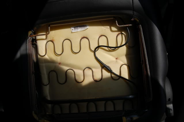

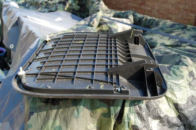

Seatbacks just PULL off. Pull from the Botton of them, then once Popped, slide them Down and off.
Power can be had in the fuse block on the passeger side of the front counsel, by the front passegers feet.
They may get Power from the headunit or DVD unit depending on what you got.

A couple pics for you to see.
