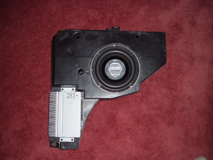

(1)First location of stock amp to the "sub"
Attached to the sub box

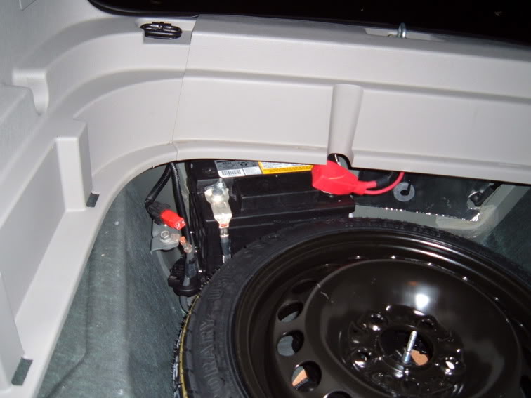

(6) is there a write up on getting through the firewall with out drilling
You don't need to go through the firewall to upgrade your stereo. Your battery is in the back hatch next to your spare.

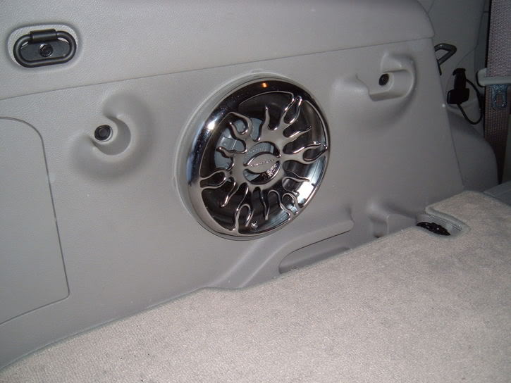

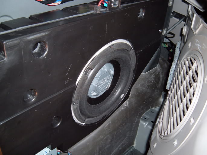

Like this?
or this?
The box you see is all you have to work with. It fills the entire rear section on that side. What you see is what there is. The factory amp is weak! 260 watts peak. I would suggest using a box and taking it out when you need the room. That's why I left my 8" after I added the box. If I have to take my box out I can hook the 8" back up so I can at least have a little bass.
