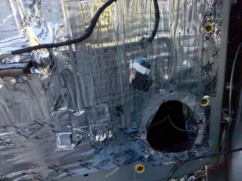

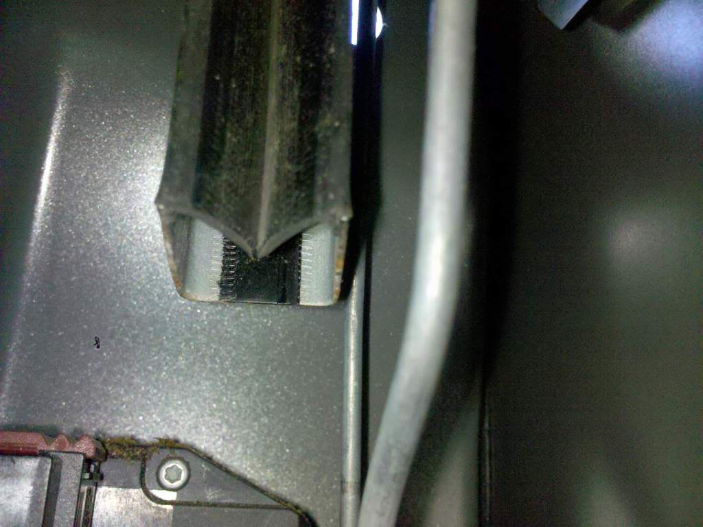

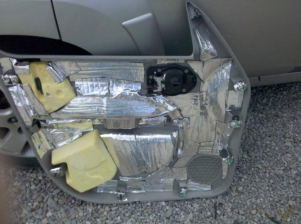

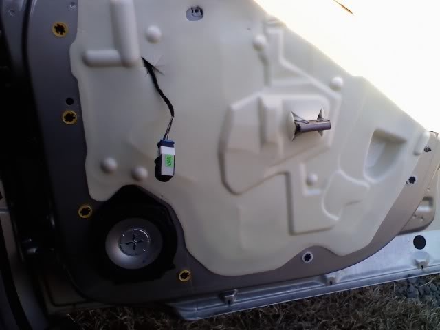

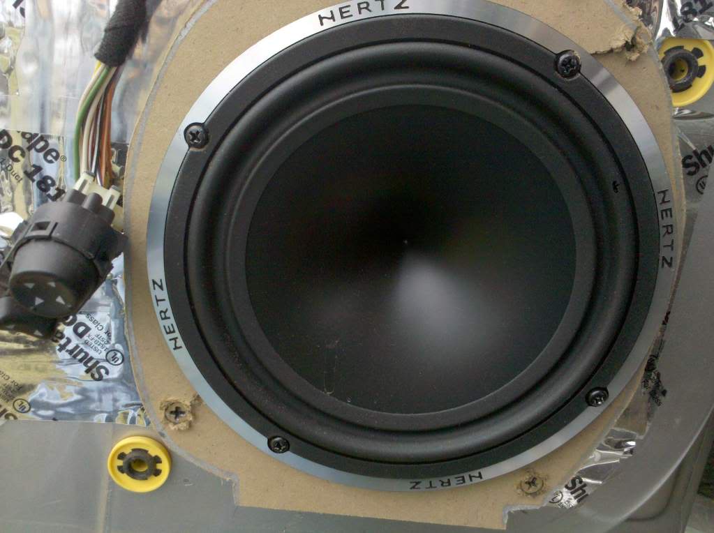

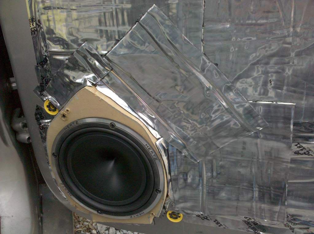

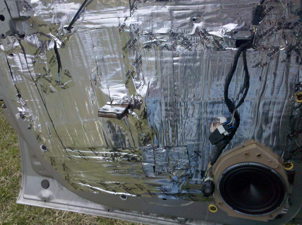

The pioneer baffles will work for normal listening, but if you're wanting to compete I'd use MDF for a more solid mount. Here is some pics of my doors, showing the baffle and deadening. The last pic is of the window track thats bolted at the top corner of each door behind the exterior handle. Its a very bad rattle spot, that took me a year to find. I unbolted it and sandwiched a piece of carpet between the two pieces of metal. Hopefully these pics will give you and idea of the fun you are in for. Theres alot of work but its very much worth it in the end.
