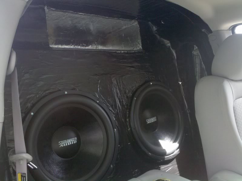

Here is one install I had in it.
Attachment 29431
This was 2 18" Sundown Audio Z v.2 powered by Sundown Audio SAZ-4500D
It managed to do a 153 @ 40Hz sealed on the dash with about 3200 watts clamped. It wasn't made to be a meter queen anyway lol It was pretty violent. Tore the car up and then some.

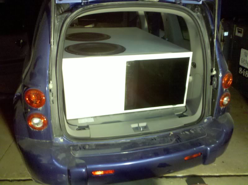

Here is another install I had
Attachment 29432
Again, same equipment. Did a 153.5 @ 37hz off 3200 watts clamped also. It really needed a larger port. Subs barely moved.

oh yea, i have to ask, how many cubes did you get out of your wall? and wtf is that black stuff, duct tape? lol

I remember you. That site has taken a huge turn in to a hole but I'll stop talking about that lol Your Mini was pretty sick! My first was wall the one with all the tape was 13 cubes after all displacements and my second wall, the orange one was 10 cubes after all displacements and the inside of the shell was around 20 cubes. I had lotsaport and tuned loww :)
The tape on that wall was what I was gunna use to fiberglass over but ripped it out before I got to that stage lol
