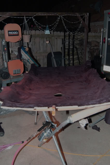

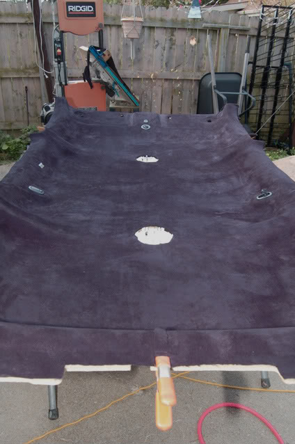

Man that Suede NON Stretch is Bi tch to install!!!
I got it done, but had to settle on one fold in the rear, I Centered it over the curve in back. And one very small fold up front in the corner by the sunvisor. There just wasn't any way to Avoid those that I could do. My first time recovering a headliner. Gonna stop by a Trim Shop and ask if they have any Tricks to dress it up. Not bad, but I know its there.
I glued the rear down first, and after Fighting it to get it as best as I could, the Spider Embossing got tossed out the window.
You can see the 2 folds in this pic. Oh well I'll also get another headliner and redo it in the Spring. I'll call this one, Pratice.
I know you said you tried yours and got many wrinkles and were gonna get another headliner, But I fought it tooth and nail to get it usable for now.
I'll get Stretchy Suede from DuBois next time.

This material isn't really cheap, it's just not made for this type application.
$24.99 a Yard, I got it on Sale @50% off. Was that Sale still ongoing?
Our headliners are a B*TCH to recover just by the way it is shaped.
A NORMAL headliner would have gone real easy with this suede, it's just a Non stretch material and needs a flatter surface without all the form fitting shapes our headliner has in it.
I was glad it didn't have a foam backing with all the manipulating I had to do lifting and relifting and shifting the suede.
Took me a few hours to get it as good as I got it, I had to respray glue as I went along.

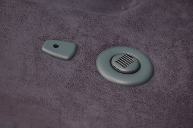

I got it back in now and finishing up painting the dome lights trim from the light gray to the Ebony, once I pop those back on it's done.
