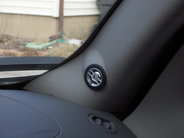

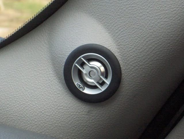

I used Rockford Fosgate in mine that came with the component set I bought.

I just used a knife to cut out the old covering and used the mounting hardware supplied to mount the new ones too.
