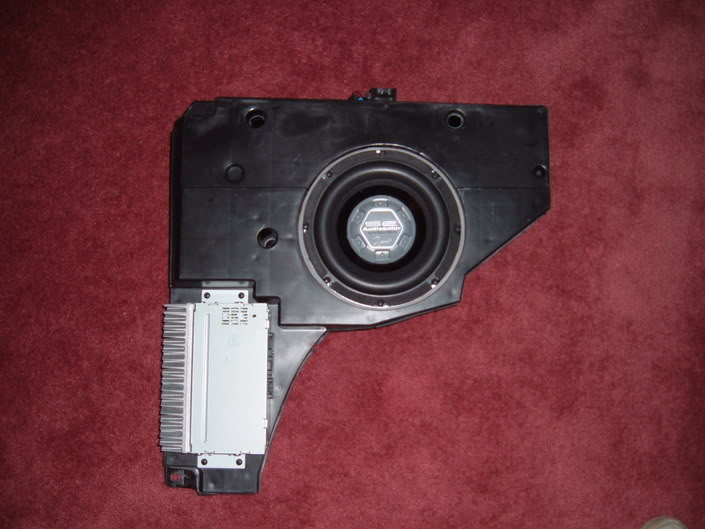

Now that I'm home I can post pics.
Behind this panel:
Attached right to the box:

Behind this panel:

Captain,
Thanks for the pics and info you supplied.. I had two shakers in a Pontiac Transport I owned before along with two Infinity 12" subs and they were great. I have 6 shakers in my seats in my living room to compliment my two SVS 20-39PC-Plus subs. They are a MUST for home theater setup and I can highly recommend installing them. They aren't much good by themselves but they really compliment a nice sub install.
