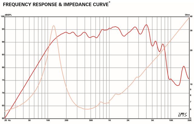

For metal I generally like Polk Audio, JBL, or mid-priced Pioneer, though I'm considering Eminence Beta 6A's....
Technically a guitar loudspeaker, some people have used them in amplified car stereo systems because of the 175W RMS continuous power handling capability & 94dB sensitivity... bonus: they're built in the USA, but cost about $60 + shipping per speaker. Low-end bass (below 90Hz) is a bit lacking as are highs (above 8.5KHz), but has very solid response in between where a lot of alt/rock/metal lives.
Here's the curves from Eminence PDF on this 8Ohm speaker
