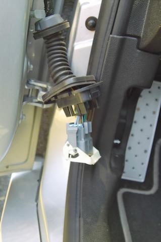

Here are a few shots I took of the passenger side. The last one is the driver's side.

Unbolting the door from the hinges ( as opposed to removing the hinges from the car ) is easy, and the bolts have a shoulder on them, or more appropriately, a neck, so alignment is not an issue. I wish I had started with the driver's door, because if I had, I would have ended up pulling all 4 off, and cut my time easily in half. I only had one run of 12 ga. into each door ( driver only in fronts, driver, tweeter, and x over in rears ).

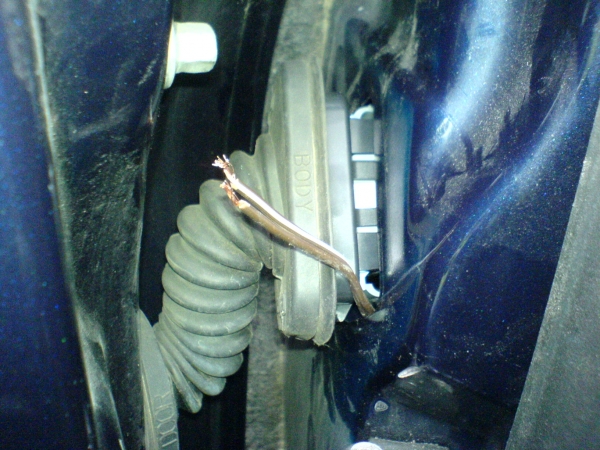

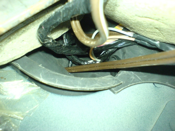

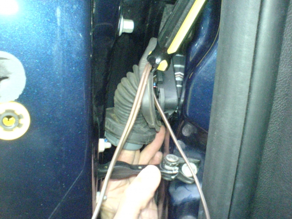

I ran the wires through the door jamb without taking the doors off. If you are able to position yourself with your head under the dash looking up, you can remove the kick panel trim and see the rubber barrier with wires passing into the frame. With stiff wire you can thread it into there, up through the frame and catch it where the door plug is.
From there the wire I used was thin enough to thread through a gap in the door plug and I used a screwdriver to push it through the rubber hose into the door. Once you remove the door speaker there is plenty of room for your arm in there to grab the wire and pull it down to the speaker hole.
I may have pics here, Ill look for them.
EDIT: here -
