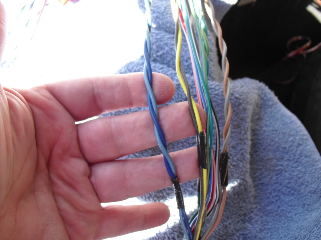

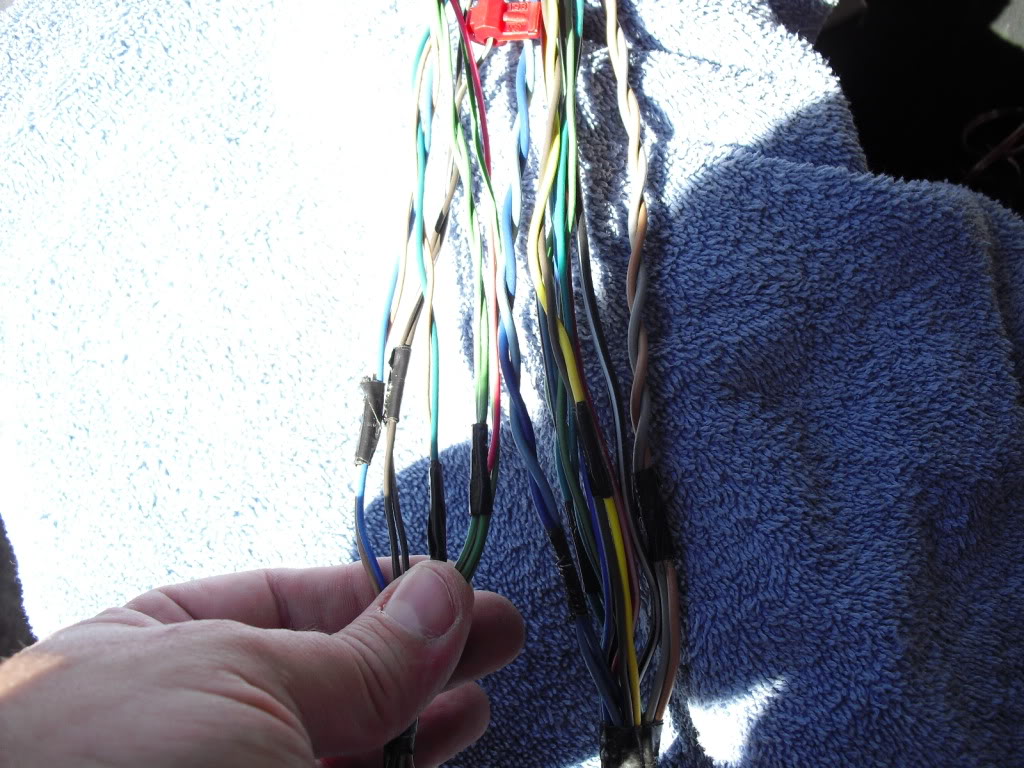

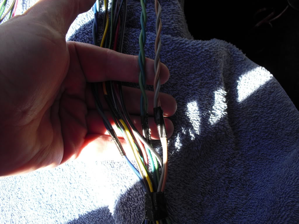

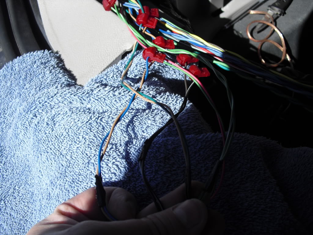

Pics of the harness for the amp.
This is all three plug-ins/connecters for the factory amp. The one in my hand is the RCA and remote on plug. The green one has the front and rear speaker wires and the bigger black plug has the pwr, ground, and sub speaker wires.

This one is all wires spread out a bit. Again in my hand are the low level RCA wires TO the amp.
Front speaker wire sets.
Rear speaker wire sets.
RCA wires and remote on AND extra light green wire can be seen next to pink wire. These two were the only two not paired (taped and twisted) with another wire.
