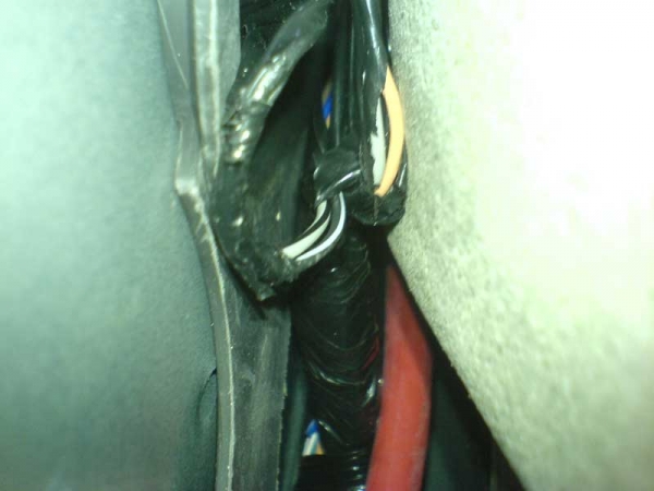

Im hooking up an amp and need to know where to cut into the front channels. I have the base 6 speaker system, I read a post that says the front left should be GY/TN. I was looking behind the front kick panel, just below the hood release, are either of these twisted pairs correct?

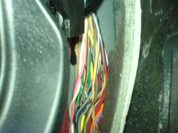

Further up, above the hood release, this seems to be the wires going to the door speaker and tweeter, is that correct, and could I cut into the door speaker for a full signal?

I just looked in the factory service manual. The wires are GY and TN all the way from the radio to the speakers. Also, the door speaker and the tweeter are wired in parallel, so you can tap into either (door or tweeter) GY and TN wire and have the full signal.
