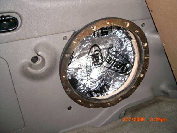

Given up on outside the box
Well, I have officially given up trying to get good sound from a free air sub without an enclosure. I will now make my expensive compartment (lined with Dynamat) into a storage bin. Here is the adapter ring I made to ensure a tight seal of the speaker.
For my ultimate solution to getting great bass and still retaining use of all three storage compartments without giving up too much cargo space, see the following link.
By the way, I built a total of three (3) sub boxes (one ported and 2 sealed) as well as comparing them all to a pre-built ported Q-Logic box, and found my final enclosure to be the best both in terms of sound and compact size. It is exactly .754 cubic feet, just what the specs for the Kappa call for.
