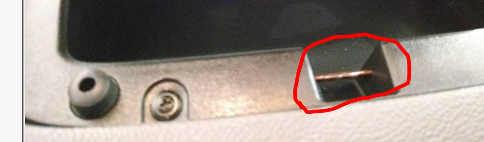

Posts: 26,533
2006-2008 models need an owner applied/GM supplied piece of plastic stuck over the latch pin so that the lid doesn't fly open in an accident. They mailed them out to registered owners, I am guessing that they would be available from GM if you asked, since it was a recall.
https://www.chevyhhr.net/forums/prob...-recall-18161/
The piece sticks on with double sided tape in the red area.
