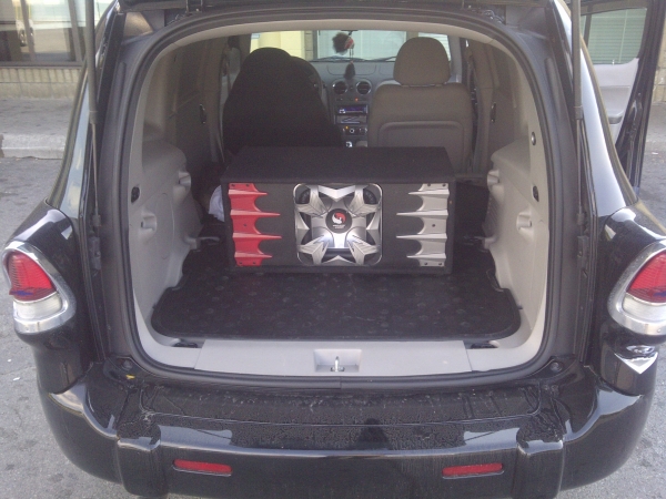

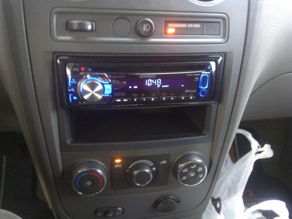

My quick install
Had a little time to add my touches to my ride
Deck is Kenwood X696

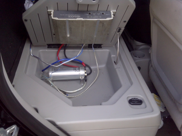

Amp is an old kenwood 4 ch (for now) and a basworx cap
And since I DETEST seeing wires and having the luxury of a panel...and before anyone says anything, yes I see the wire there!!!! haven't completely finished yet
And my almost complete Kicker L7 Solo-Baric
Let me know what y'all think

clean install!!
Old Oct 2, 2013 | 03:43 PM
  #315
Heavywrecker's Avatar
Joined: 04-18-2013
Posts: 63
From: Hamilton, Ontario, Canada
Originally Posted by Oldblue
clean install!!
Why thank you!!! Not too shabby for an hours work. Just wish that sub didn't need such a big volume box. Maybe should hit up pyro for some fibreglass work and find a way to hide it in the stock spot

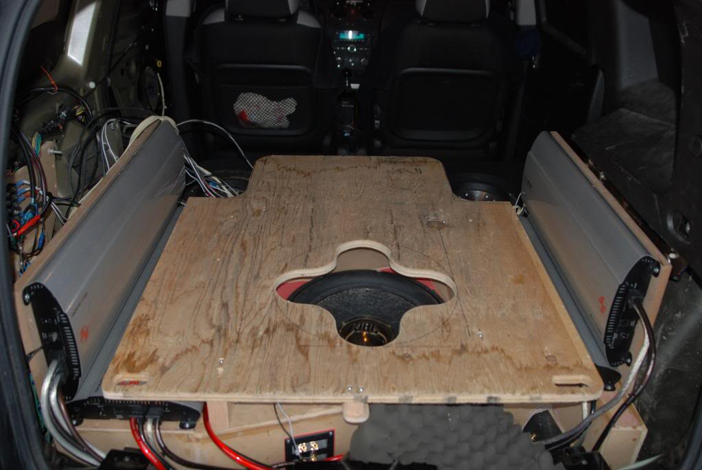

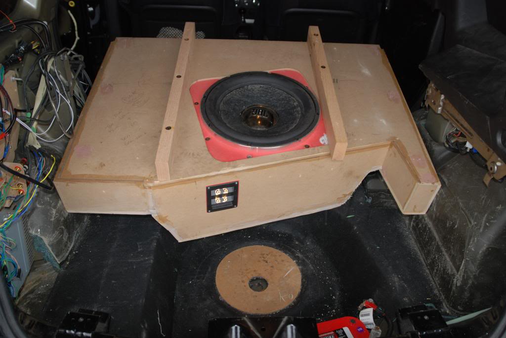

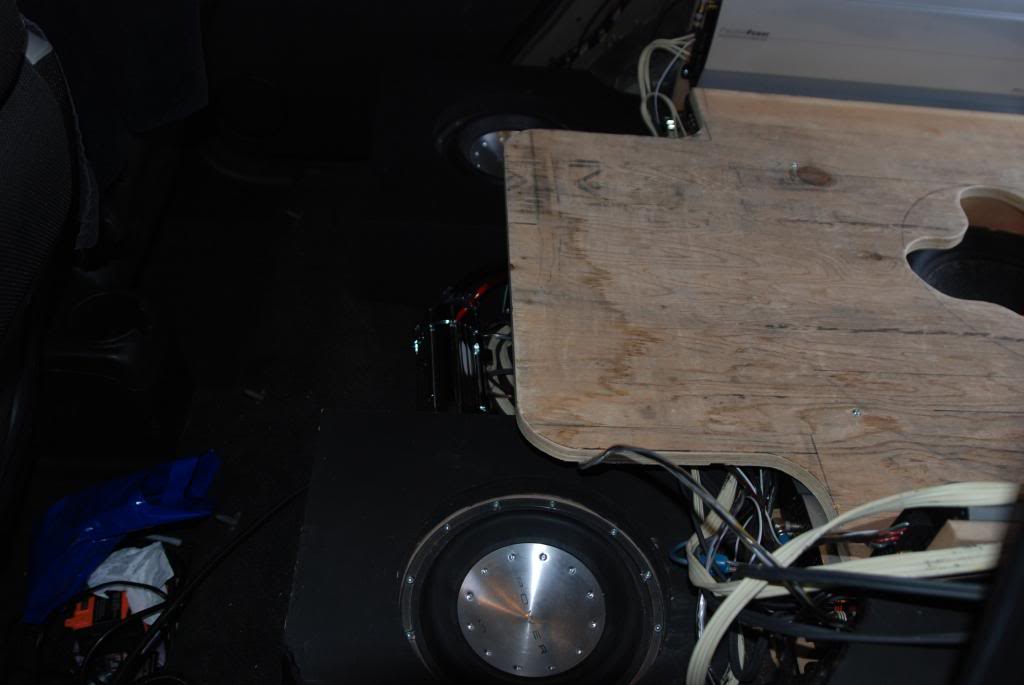

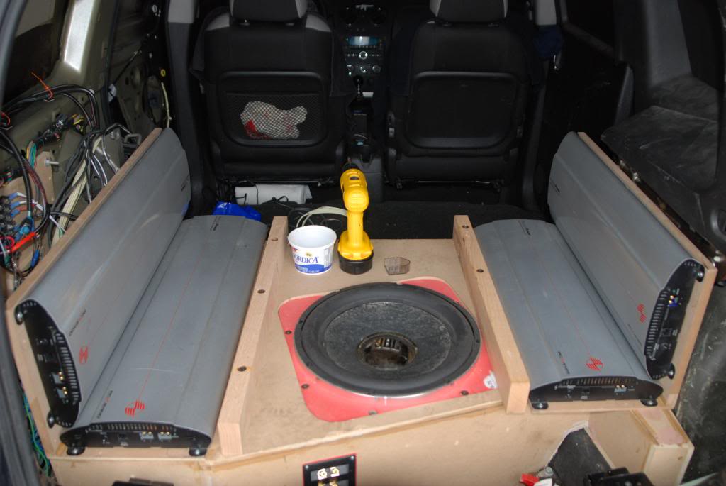

one 15 and 2 10 subs.
i use the hhr for work. took out the storage bins for the 10 and removed the spare tire for the 15. added an epicenter to get the low end out to compete with road noise

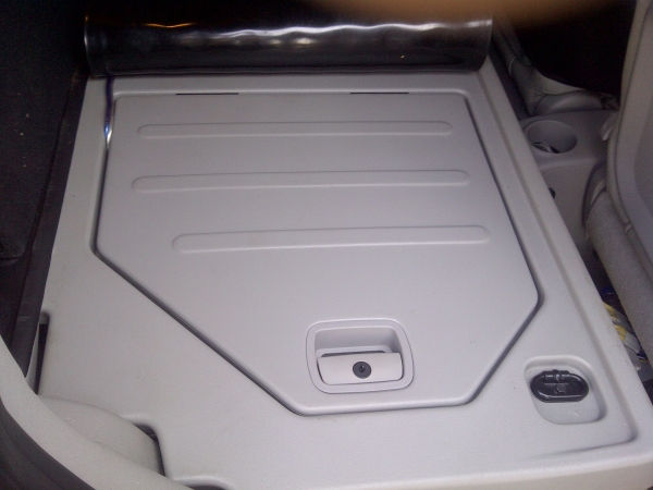

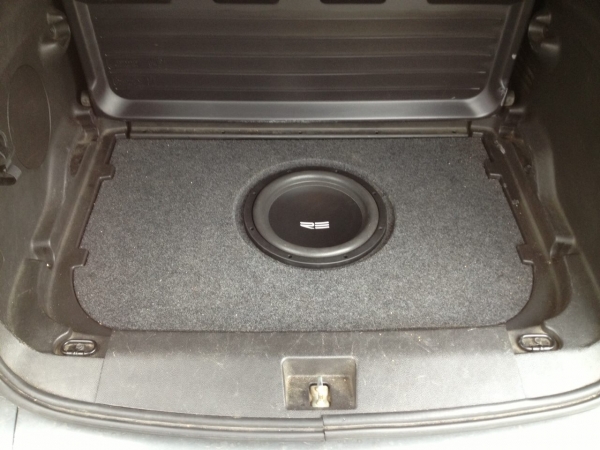

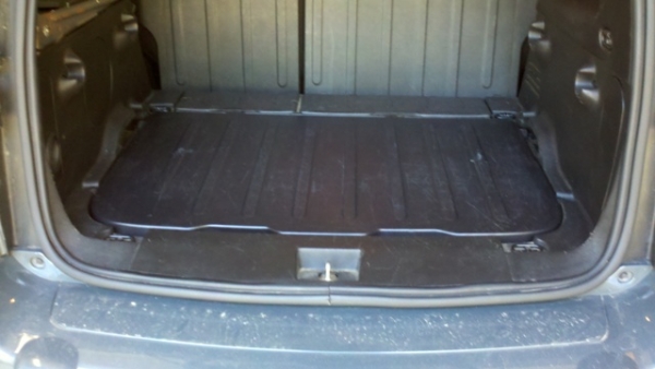

Here is my current setup.
12" installed under the rear deck...
WITH the spare tire in its original location (only flipped over)...
This is a sealed box with somewhere between 1 and 1.25 cubic ft. Hard to calculate with the round 'sump' portion.
##This box is for sale HERE
Amps are located in the factory subwoofer location with forced air cooling (via hidden computer fans).
****Please excuse the 'dusty' look. I have since cleaned it all up
Now you see it....
Now you don't....

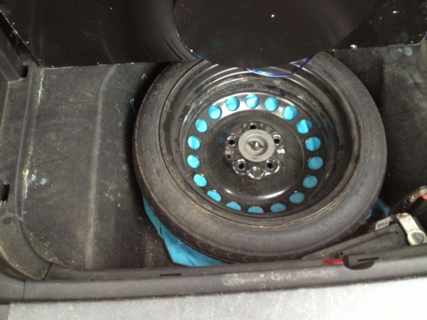

Spare tire still in factory location....
(the blue towel is there so I can wipe myself off after an emergency tire change)
