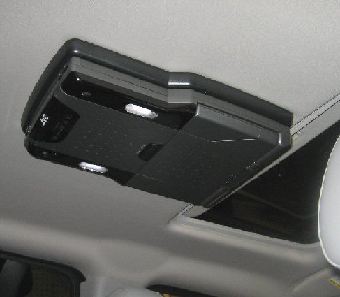

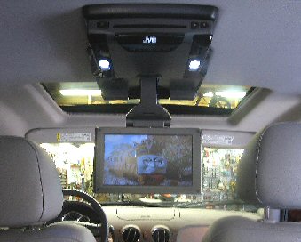

I faced the same quandry and opted for an overhead console with flip down 10" monitor. Managed to install it even though my HHR has a sunroof. With wireless IR transmitter and FM modulator, it does not need to have any direct wiring to the head unit.
The grandkids listen with their wireless headphones and we can still listen to the radio.

WOW! I didn't think you could put in a flip down w/ a sunroof!! Did you install it yourself? Does the sunroof interefer with the flip downmonitor? How stable is it? Thanks in advance for your help...

did you lose the ability of the sunroof?

BTW...here's your photos.

I also have a flip down(no sagging) and mounted the dvd player under the passenger seat to the wide bars using large zip ties. No problems opening and closing my sunroof. I do have mine connected to the head unit due to the fact I play music video dvd's. I also have the option(when the kids are in the car) to use the wireless head sets.
