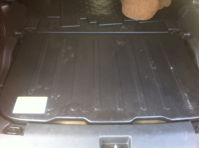

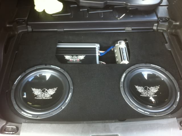

Cant help as far the RCA's go cause I have a 7 indash tv. I did a box where mine could be covered by the rear pastic piece. Here's a pic.

Rob you don't have any vibration issues when the load tray is over the speakers? That just looks like it would create a bandpass scenerio when the cover is on and would allow for vibrations.

Is your set up an enclosed box that sits in that area?
Mine isn't, it's just the platform and supports around the outside to keep it in place.
I'm still messing with the settings to get it where I want it, but I'm thinking it that it's not hitting as hard as it should due to the box isn't technically sealed...I'm not good with this crap, so figured I should ask.
Are those subs sealed or is the box the cargo area behind the subs? How is it sealed?
