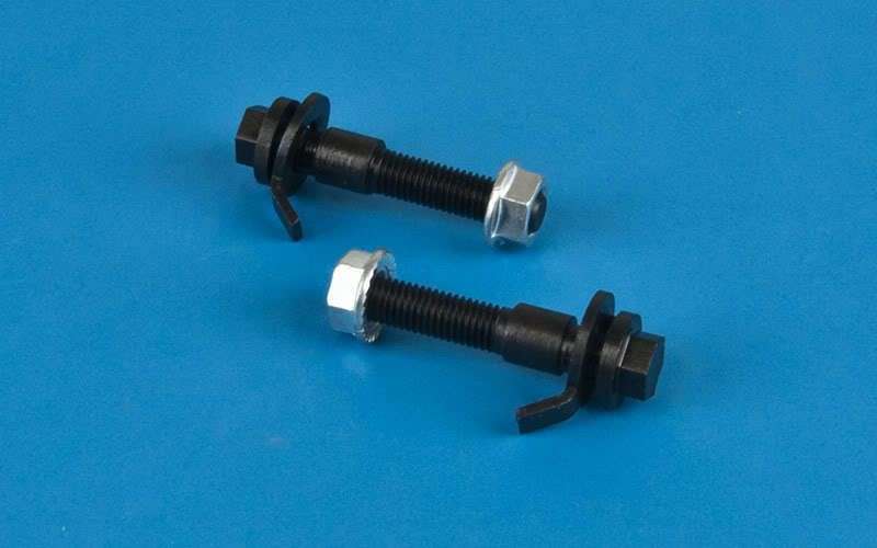

I have seen the camber adjustment bolts advertised. Is that how I have to fix this?

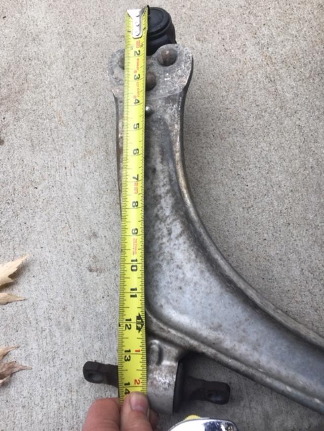

Well I measured the need control arms and the old ones. Sure enough the new ones are about 1/4" longer.
New ones are 13", old are 12 3/4" Measured from the casting bump. Casting bump to bushing CL same on both.

Seems like the more accurate measuring would be pin to pin.

I took a chance on off brand parts. $100 for the pair. Now I know why. I could make them work with band aids. But then I will have the opposite problem next time I replace/upgrade. Get what you pay for. I just thought that if someone screwed up knocking off a die cast part, there would be a lot of them out there.
Yes, there are lots of more accurate ways to measure. I just needed to convince myself they were different.

I had the same experience 6 years ago. I just put the camber kits in. Don't know what you mean they aren't as strong. Those bolts only need clamping force.
