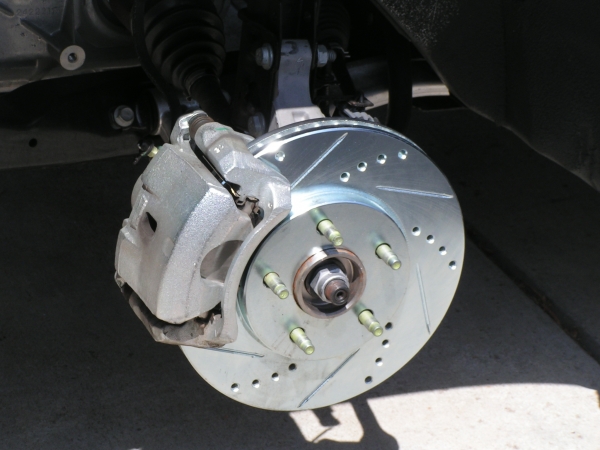

Thanks a bunch for the tip regarding R1Concepts. I installed my new rotors today and after a 30 minute drive, the pads mated with the rotors.
I had a bit of pedal pulse for a while, but it all smoothed out.....

I discovered that slotted disc rotors are directional. My picture above shows the rotors installed incorrectly.
I swapped the rotors this morning based on this info from Brembo....
"The discs should be installed such that the end of the slot nearest the outer edge of the disc contacts the pad first."
Hope this helps someone....
Cajun
Cajun
Well you got me wondering Cajun, so I called R-1 and talked to tech support. I was told that I had my rotors installed correctly. I was doing google searches yesterday and a I saw them installed both ways in different applications. If you look at Hvrods pic which is a rear brake set up, it is turning the same direction as my rotors with the slots and vents angled to the rear.
However the R-1 guy said they would work in either direction but for maximum stopping power angled to the rear.

So which direction should the slots be facing??? Any pics with them on right?? My feeble mind is not visualizing how they look correctly
Goose
Old Jun 16, 2008 | 12:32 PM
Todd TCE's Avatar
Former Sponsor
Joined: 10-03-2007
Posts: 45
From: tempe, az
Originally Posted by Goose
So which direction should the slots be facing??? Any pics with them on right?? Goose
Like was stated; it won't matter. That was the point of the link to various patterns and designs. I call it "builders choice". And of course as you'd expect each supplier makes claims to why theirs is superior.
As for "power", a rotors torque is calculated by it's diameter (combined with piston area for clamping and pad coefficient for friction) to produce total toque value. Slots, holes, dimples, vented or solid, even a pizza pan of the same size won't change the physics of the calculation for torque (power). Albeit your pizza might taste a bit funny the next time....
Choose whatever way makes you happy is all that matters. You'll note the pic link above shows the true design of a directional rotor. You'll note the castings internal air passages are such that they draw or suck air from the center eye of the rotor and vent it outward at the edge. That was the main point to convey.
